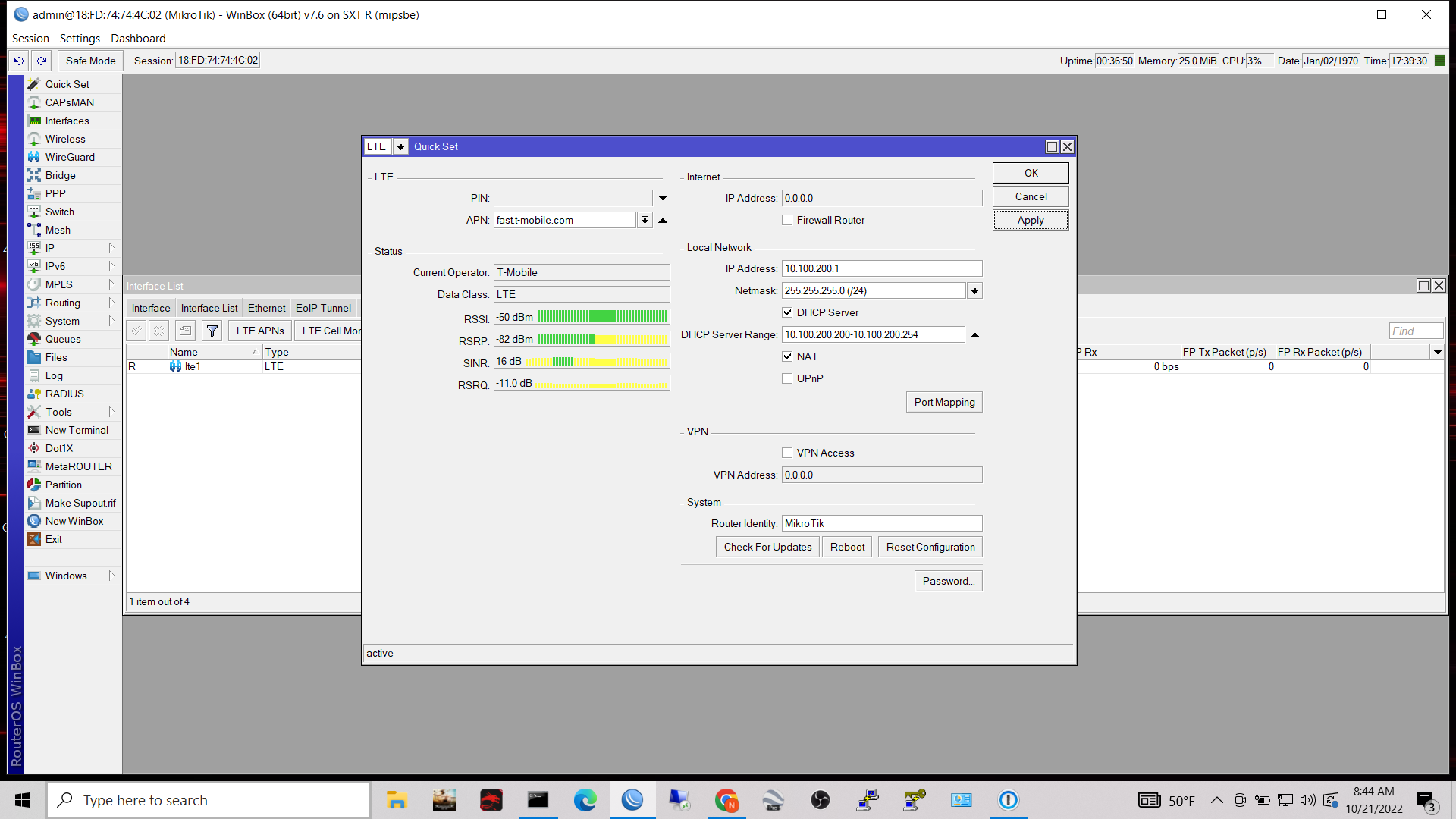

Just as a visual reference,
Before the firmware upgrade, there was an IP address in the Internet field, and the same one in the VPN field. Now they are just 0’s.

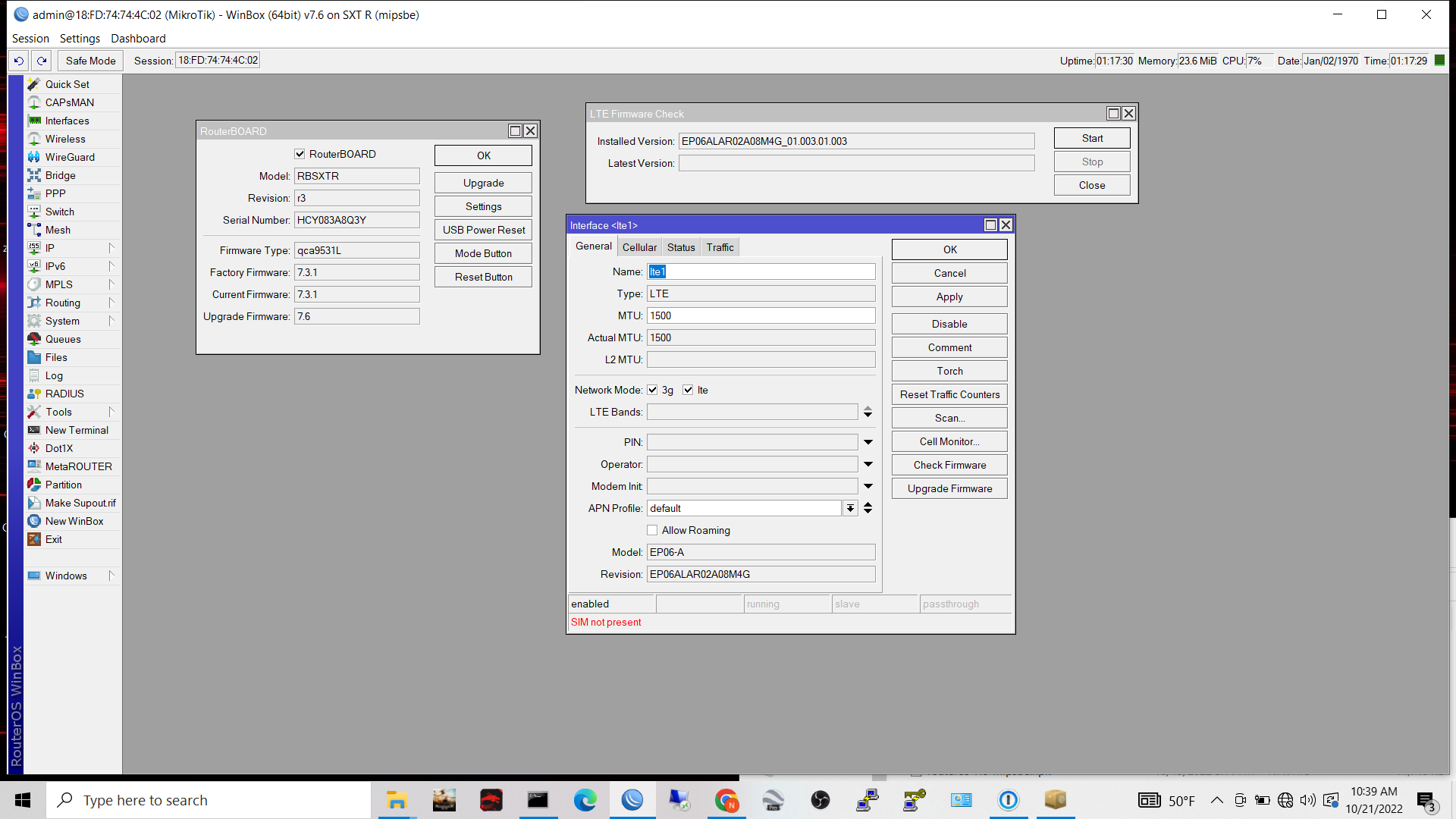

After doing that, it still has ROS v7.6 as the package(it shows v7.6 on the top bar), but when I go in and look at the RouterBOARD window it shows “Current Firmware” as 7.3.1 with the option of “Upgrade Firmware” to 7.6.
Here is a screenshot;
Also, a screenshot of how the command does not work.
