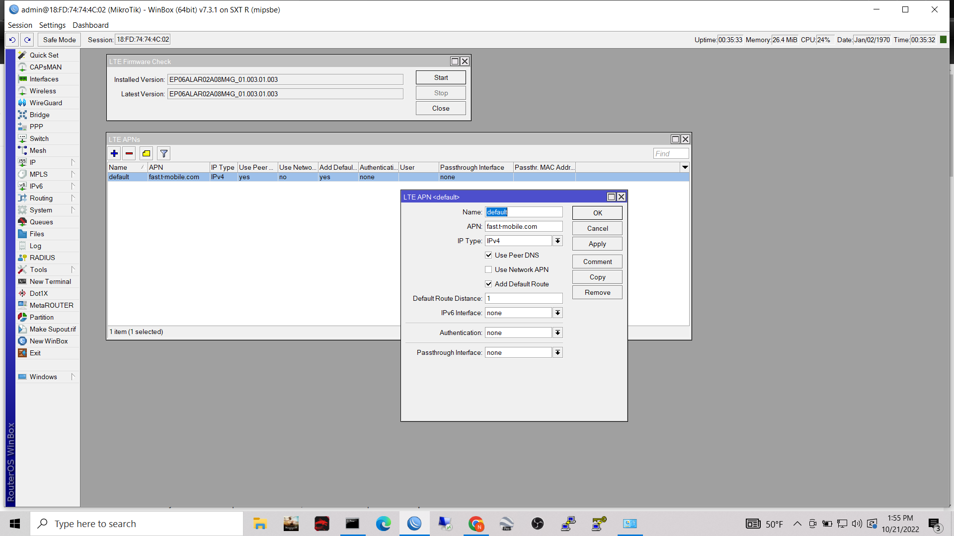

It was all in the APN settings. I will put a screenshot in of what they look like in case anyone decides to use this with T-Mobile and they do a firmware update on the SXT LTE6.
Of course, I still am on the 7.3.1 version, but when I do an LTE Firmware Check it is running the latest in that. I do not believe that upgrading the ROS to v7.6 is going to change anything.

lol, yes, you asked about the APN. However, as far as I knew it was correct.
When talking with the guys at T-Mobile, I told them what I did to get it working, and he said he was just about to suggest what I did. He said he normally only see’s the issue with 5G devices. But for some reason, with the new LTE Firmware, the “auto” IP Type does not play nice - have to force it to IPv4.
Also, before the new LTE Firmware update, the “Use Network APN” box was checked and it worked on the default “internet” APN.
So all of this revolves around the new LTE Firmware update.

Got the new SXT LTE6 kit-US in. Went through all the steps as before. Upgrade the Router OS to v7.6, upgrade the RouterBOARD firmware to the same, upgrade the LTE Firmware, make sure the APN is set exactly like the other one. In fact, set everything but the lan IP address the same. Same across the board.
Yet again, after the LTE firmware upgrade and a reboot - no connection/internet. Actually, it would ‘connect’ to the tower, but it would not pull a proper IP address, just pulled a private 192.0.0.2 address.
I tried everything. Swapped out SIM cards. Went through ALL of the configurations to verify that it was all the exact same as the other identical SXT.
Figuring it had to be an APN issue once again, googled up T-Mobile’s APN’s. Found one that is for ‘older devices’ epc.tmobile.com - and that made it work.
So why would the same devices, running the same configuration/software/firmware, have to use completely different APN’s?
It has to be an issue with the LTE firmware for this device. It is the only thing that is causing this. I do not know anything about how all that works, but it has to be a bug right?

Update -
Been in contact with Mikrotik Support. They released a new LTE module firmware for it. Upgraded both of my SXT’s and now they both work great.
Fingers crossed the issue is resolved now, but huge props to Mikrotik for getting on top of this quickly.
