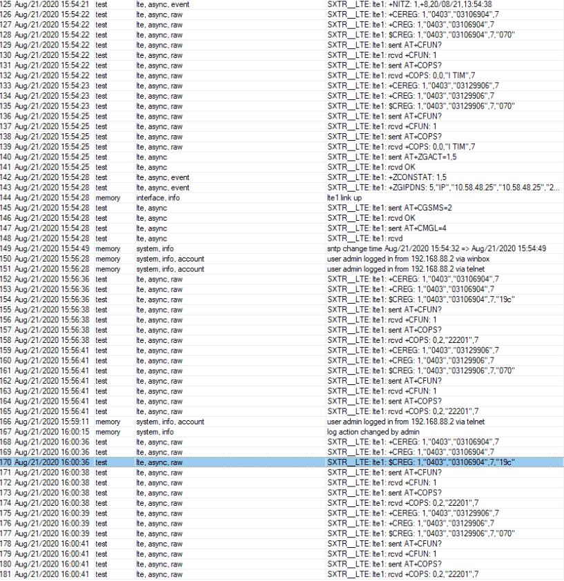

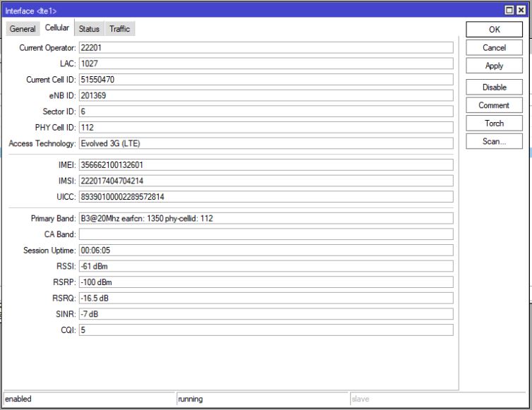

I’ve a problem with a SXT LTE6 kit (upgraded to the latest stable version 6.47.2) that has a SIM card from the italian provider TIM. I’m far away from the tower about 3 km, band 3 and 20. I’m not using any cell lock.
Internet connection is discontinue: the interface LTE1 looks always connected but, enabling the advance log on that interface, I discovered that frequently the modem looks for a new signal and reconnect (see the attached log).
The LTE interface has been upgraded to the latest version available (R11e-LTE6_V025)
I’m not really expert on this topic, so maybe this behavior is normal and in line with a poor signal quality or maybe there are other settings/checks that you can suggest to me.
