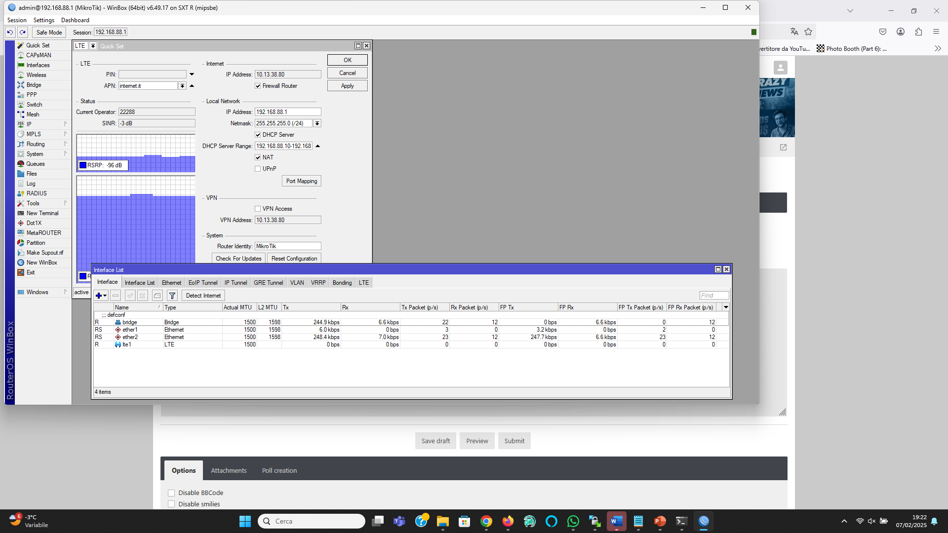

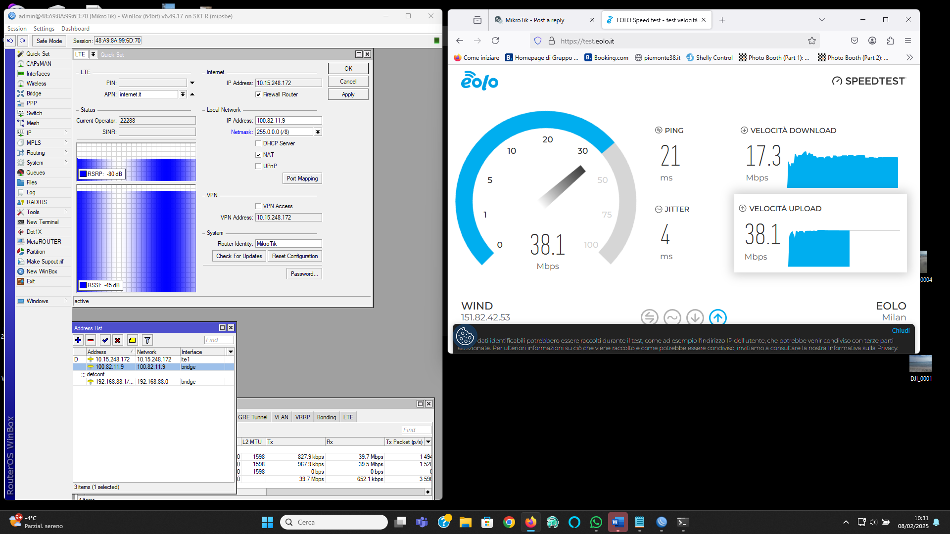

Today I changed the Address List where I had
10.13.255.112 associated with lte1 interface
100.82.11.9 associated with lte1 interface
192.168.88.0 associated with lte1 bridge
changing the 100.82.11.9 associating with bridge interface
After this change internet navigation works ! I’m not really sure if this was the problem, but it works now.
Do you think is correct ?
The image does not show.
Here’s the snapshot, not really convinced that changing
the 100.82.11.9 associating with bridge interface is the
correct solution, but works. Just for reference which is
the command line that show me the full (if exists) configuration
It might be doing so added a missing route ?
Can you post output of
/interface lte apn print
/ip route print
Here's the output :
[admin@MikroTik] > /interface lte apn print
Flags: * - default
0 * name="default" apn="internet.it" use-peer-dns=yes add-default-route=yes
default-route-distance=2
[admin@MikroTik] > /ip route print
DST-ADDRESS PREF-SRC GATEWAY DISTANCE
0 ADS 0.0.0.0/0 lte1 2
1 ADC 10.13.255.112/32 10.13.255.112 lte1 0
2 ADC 100.82.11.9/32 100.82.11.9 bridge 0
3 ADC 192.168.88.0/24 192.168.88.1 bridge 0
