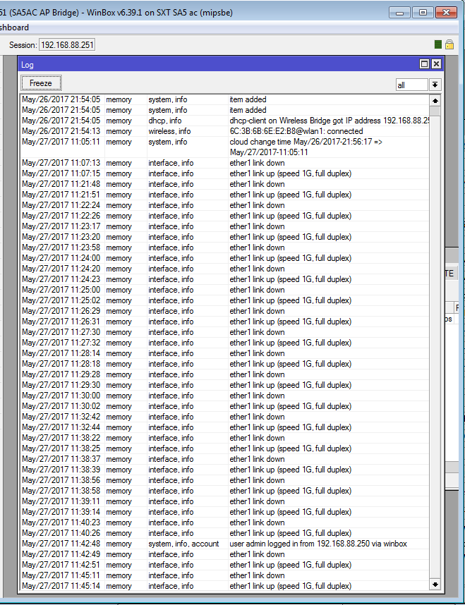

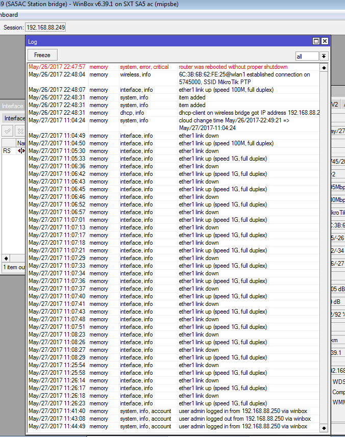

I bought 2 SXT SA5AC, i wanted to set them up for point to point link. I followed a guide and succesfully get them working, last night I can transfer large file between 2 device with max transfer speed of 20-25MB/s so maybe roughly 200mbps. Today I tried to transfer files again, I got this unstable connection and ether1 keeps dropping out intermittently. What seems to be the problem?
I attached the error log.
SXT SA5AC as AP Bridge
and,
SXT SA5AC as AP Station Bridge
also, now the transfer speed won’t go over 9MB/s, cables is cat5E, and the router RB450G, both pc network card is gigabit. yesterday the transfer speed was 20-25MB/s.
