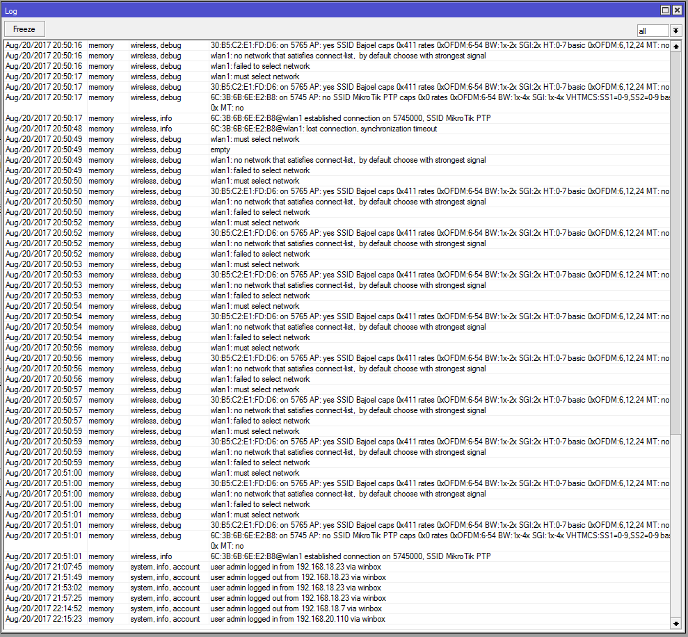

I attached the log file.

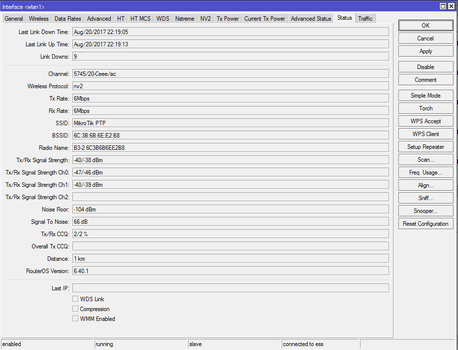

and the wifi status below
note the bad CCQ, only 2%…

Indeed, CCQ is very bad. But that’s normal if you can’t get a good connection. I think the RSSIs are a bit high also.

    • In your log file is the fact that no networks match connect list entries.

Also, it’s clear that the “Connect list” entries are giving you problems and are probably the biggest culprits; disable them. In the wifi parameters of both routers, enter your SSID and security profile, and enable “Default Authenticate” and then see if you can connect. If you’re connected, then decide what you want to do with the connect list. If you want to use connect lists then on the STA, go to the “Registration” tab, doucble-click the entry for your AP and click “Copy to connect list”. Move that entry to the 1st position. Connect lists are read sequencialy (1st to last). On the STA again, uncheck “Default Authenticate” WHEN AND ONLY WHEN your connection works. It will drop the connection for a few seconds.

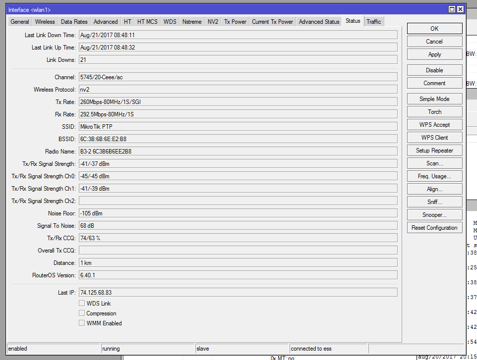

As you can see, link has been down 21 times, but at the moment it’s been working again for 3 hours without problem.
things to note, my CCQ is still bad, sitting at 65~75%, also distance field says 1km, but actually our place is just 200meters apart.
