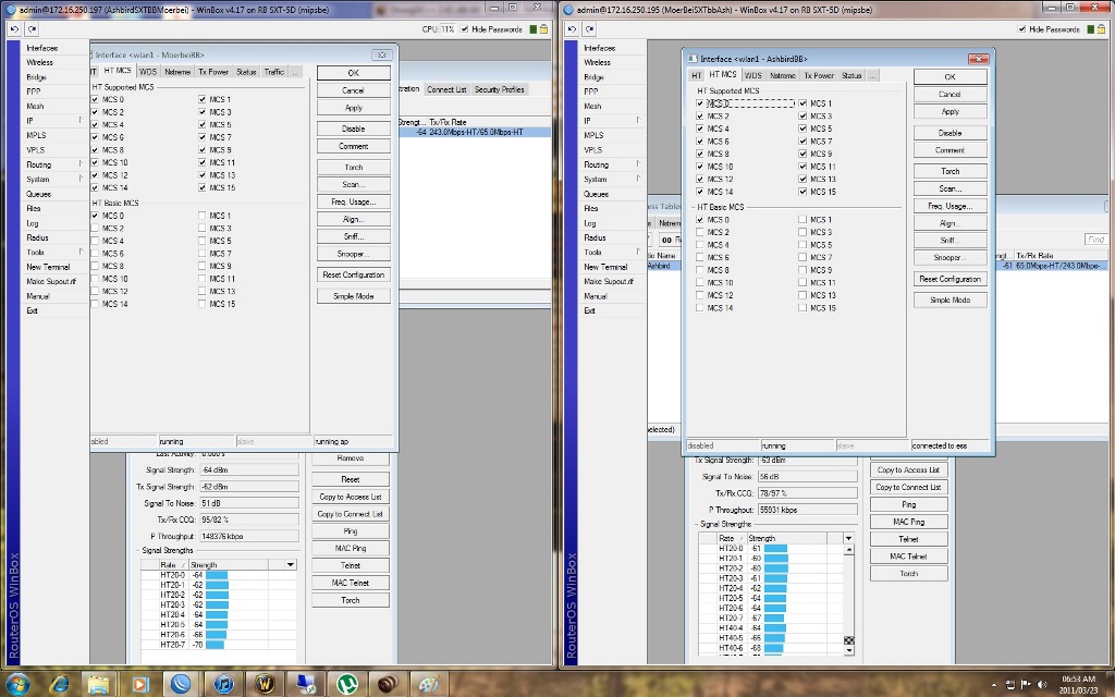

I have two SXT’s linked together about 2KM apart. I have upload two seperate images from these units;
The problem I am having is as follows; If I leave the SXT’s on default speed selection I get a connection of 243Mb/65Mb with a 148000/55000 P-Throughput and a decent CCQ (90’s). The DB rating on both connections are in the low 60’s. The 65MB never increases no matter what freq or even at 100% CCQ

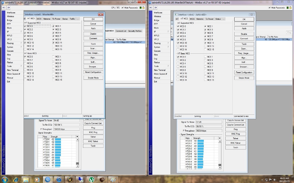

If I ratelimit the SXT’s as per the second image uploaded, I get a 150MB/150MB Connection with similar CCQ and DB rating as above. As soon as I unlock one more speed rate the RX drops from 150Mb to 65Mb.
Why would the SXT drop one link to 65MB ?

Can you provide your settings to achieve the 150/150 rates? I’d very much like to duplicate this issue. Please be as specific as possible (what protocol your using, etc.). … and what interface are you programing your SXTs with (Winbox, ssh, etc)?
Thanks!
