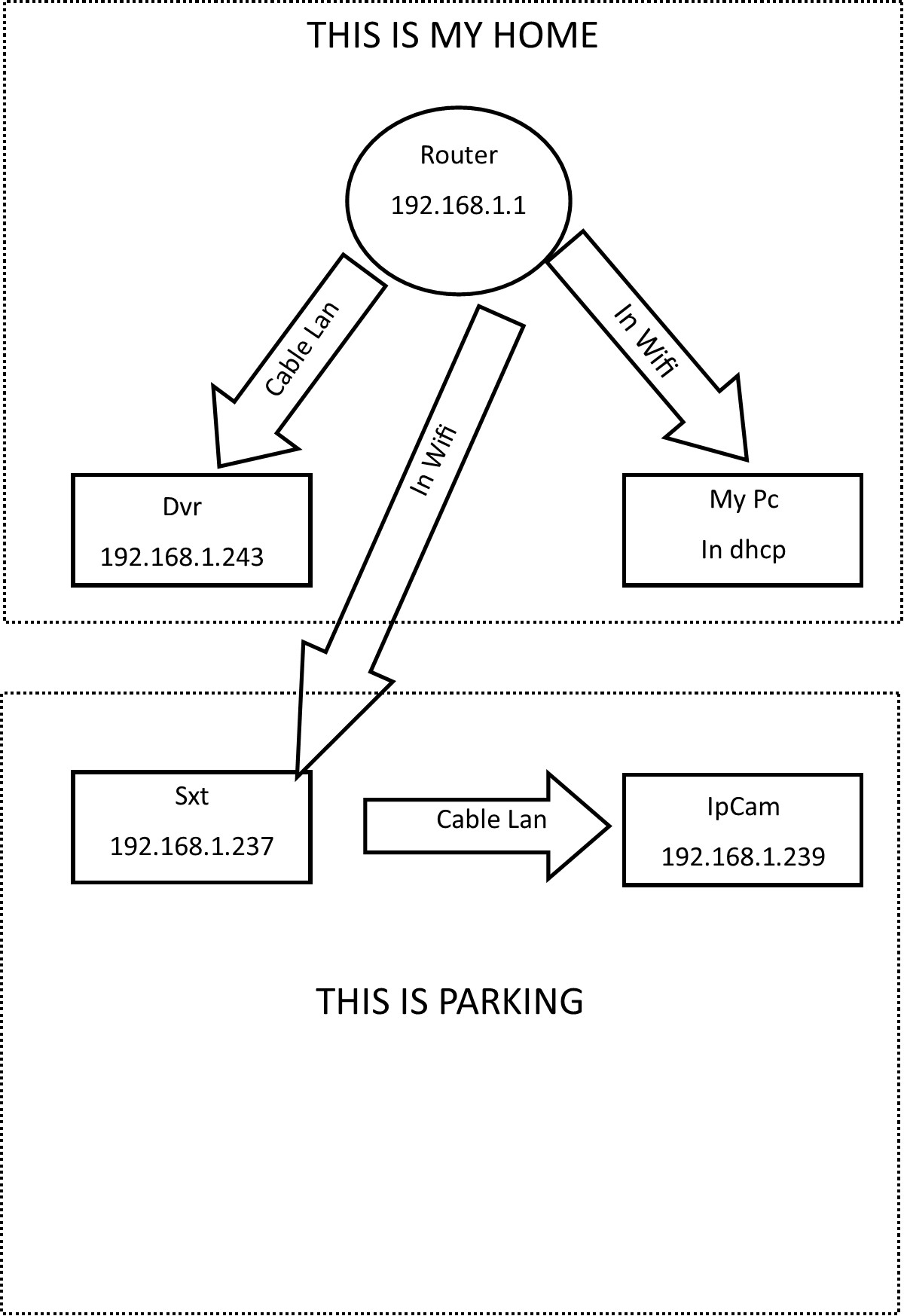

Can you provide a simple network topology diagram so that i can understand what is the configuration needed ?
The Diagram is Attacched
The router, is it a MikroTik ?
nono…is telecom tim Hub
station-pseudobridge should work just fine…
