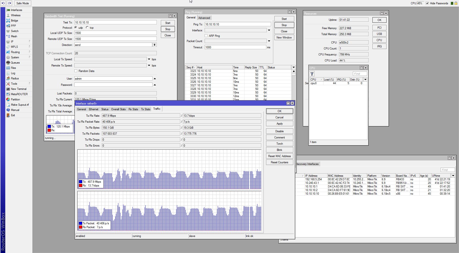

Setting nstreme and frame limit to 1580 so lower than l2 MTU of wireless gives
100% CCQ 866,6Mbps wireles data rate and… max 200mbps HDX of udp btest.
NV2 is behaving as wicked when no upper limit varying 200-450mbps.

please try to check the throughput speed using the Traffic generator:
http://wiki.mikrotik.com/wiki/Manual:Tools/Traffic_Generator
Also please show us your signal and CCQ levels. Just to rule out that devices are too close together or there is some other factor.

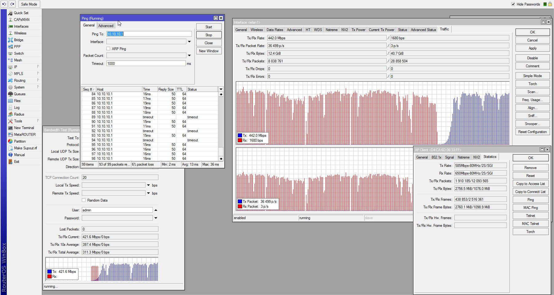

I lowered txpowerf to 0, 1 and 3 with all rates fixed. so i got about 60db SNR ccq varyies from 50 to 90%. ohhh if I could set QAM16…
i have similar problem to this one with ccq and stability in this thread http://forum.mikrotik.com/t/sxt-ac-best-settings/79554/23
cannot anyhow make it works stable :confused:
ok I got some results. distance 11km, rocketdish and jirous well shielded, clean channel for testing test done over sxt (RB493G-CCR1016)
signal -61/-62 SNR 51 dB
802.11 :
CCq 50-70 / 50-60 %
wireless rate tx/rx 526/351mbps
btest (over sxt) one direction varying 150-250mbps lots of stall
ping avg 12ms max 63ms
nv2:
2 ms frame
ccq 50-70%
wireless rate 270/351
btest 50-150 mbps even more breaks
ping avg 14 max 82 10% loss…
link is UNUSABLE
nstreme:
best fit 3200:
ccq 70-80%
wireles rate 351/520mbps
btest quite stable 160mbps
ping avg 16ms max 27ms 0% loss
