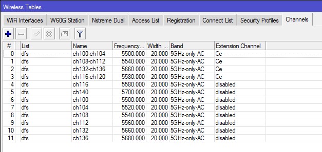

  5. Check freq-usage and snooper again. And do use DFS channels, they even have a stronger TX power (EIRP) allowed. Wait 1 full minute for the AP to start transmitting. (Channel 120-128 waits 10 minutes). At 5700 MHz your disconnect is 1 minute if it is a radar detected. So make a channels list at the “bridge” side, to make it choose another channel, avoiding the 10 minute channels.
