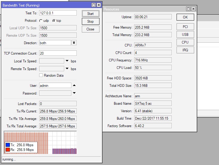

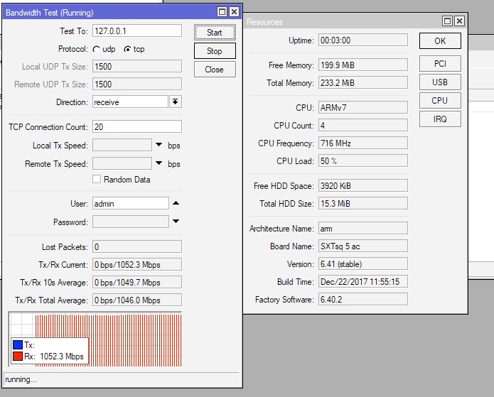

@mistry7 could You please test TCP throughput regarding new CPU used in sxtsq.
just run TCP bandwitch test to 127.0.0.1.
here…
Both directions
one direction
Test does not support multiple Cpu Cores…
ROS is way behind the Hardware can do…
I’m wondering if you understand that this way you test how fast the btest itself works. And the results of such “test” has nothing to do with how fast your router can forward traffic, i.e. pretty much useless…
pretty much useles untill You compare it to other mikrotik hardware results.
And YES it reflects CPU efficiency utilization by ROS and that is what I wanted to know.
It reflects CPU performance under a particular load- in this case bandwidth test application. Profile for other types of load may differ greatly, and this is especially true when you compare totally different CPU architectures (like ARM vs MIPS-BE). So, basically, it is especially useless when you compare hardware of different CPU architectures.
