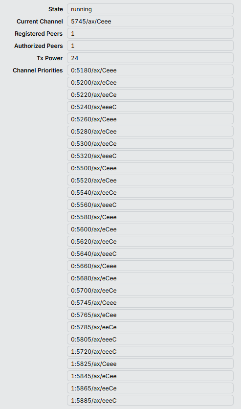

Very simple setup, one SXTsq 5 ax as AP, other SXTsq 5 ax as client-bridge 180m away, perfect LOS.
I made simple cfg1, set SSID, country superchannel, band 5GHz AX, chann.width 20/40/80, freq 2300-75000
THE signal are -70 at best !!!!!!!!!!!!!!!
there is SXT SA5 ac near, that I see -40, as expected to this range
Are there something I misconfigured? Or is this joke and new bright future of WISP hardware?
Thanks.

NGL, I avoided using sxtsq ax on a new project and went with sxtsq ac as sxtsq ax is a new device. Can you change wireless from AX to AC only on both devices and see if signal improves? RouterOS 7.24beta1 is installed on device, I don’t see any posts with issues on this OS. Can you change country=Superchannel to your actual country
Try first non-edge channels @ 20MHz, then find manually the best.
auto-frequency do not work well as expected...
# 2026-06-04 16:27:11 by RouterOS 7.24beta1
# model = SXTsq-5axD
/interface wifi
set [ find default-name=wifi1 ] channel.deprioritize-unii-3-4=no \
.frequency=5180-5320:20,5500-5720:20,5745-5885:20 .skip-dfs-channels=disabled .width=20mhz \
configuration.antenna-gain=16 .country=Superchannel .mode=ap .tx-power=40 disabled=no

5240MHz gives -57
somewhat better but nothing compared to older AC products
