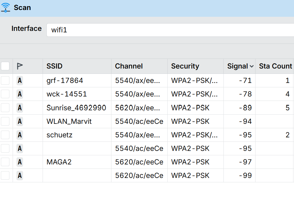

I cannot see my 5Ghz SSID called test with a simple password when I perform a scan. However I can see the neighbours SSIDs. The SXTsq is around 3 feet away from the Access-Point. Testwise I used another Fritzbox to generate a 5Ghz SSID and even this one I could not see. I have a fixed channel 48 and set the country code to Switzerland. I just configured it minimally like SSID, password, country, Band.

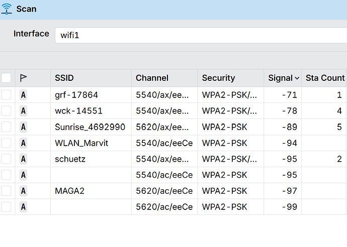

What I dont understand: I see all the neighbors Wifis which are like 6-10 and probably configured in a very standard way (DCS, WPA2, visible SSID)

These are the neighbors networks that the Mikrotik can see.

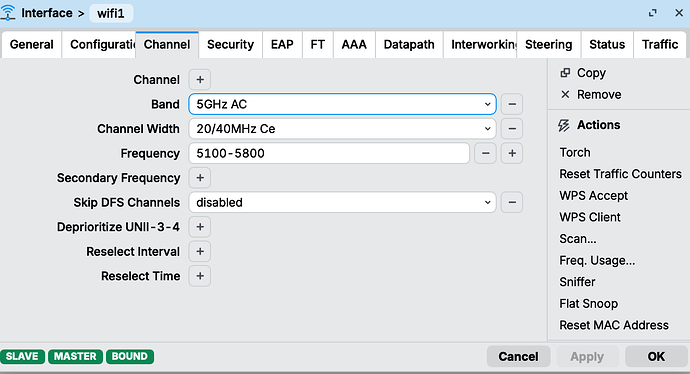

Check what's in your channels tab.

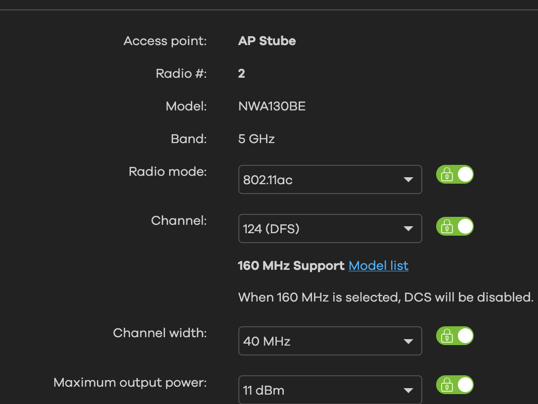

Try setting your test access point, which you don't see, to a channel from those you see, for example, 5620
Also: unset the empty setting security.encryption="" ... it disables all encryption algorithms and that's not right for WPA2.

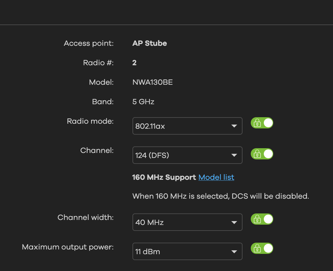

@holvoetn yes, the SSID is not hidden, I can see it from all my other devices like smartphone, notebooks, tablets.

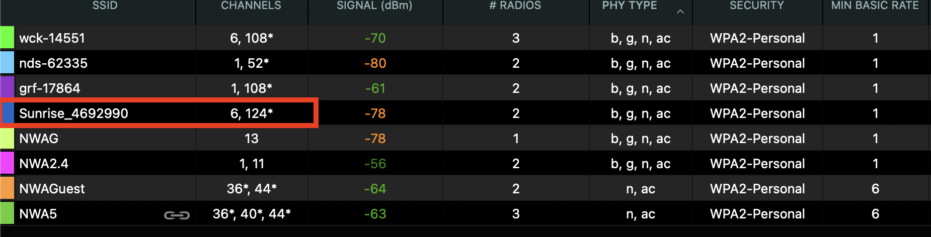

@safelogj great input, I see that the surrounding networks are on DFS channels. I have changed mine to channel 124 as one of the networks I can see within the scan. However I still cannot see my test-SSID.
@mkx thanks, I have enabled all encryption types, however still cannot see my test-SSID.
What I dont understand: I can see all the surrounding networks, why shouldn’t I see mine? The surrounding networks. I tried to config as little as possible to see all networks and then

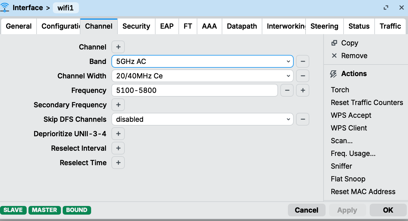

config of the 5Ghz radio.

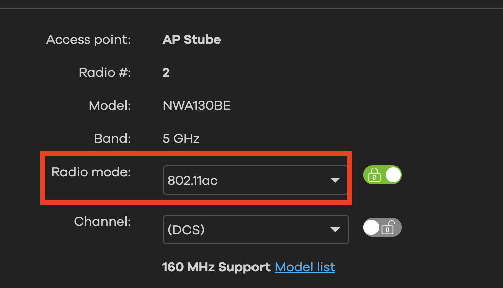

you AP is ax and you station is ac?
sorry, no the AP is AX and station is AX. I have set the AP to AC and the station AC testwise, however still I cannot see it during the scan.
I have tried the channel widths: 20/40Mhz Ce, eC and also 20/40Mhz.
