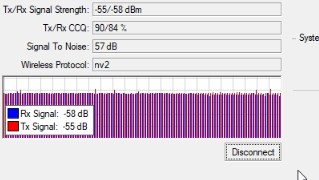

Tried every protocol, at the moment I’m with nv2, but the problem il the same also with 802.11 and nstreme. Tried every possible frequency, made a frequency scan and tried using free frequencies. The thing that drives me crazy is that the problem occurs randomly. Other times the link is perfect as per the attached image. Thank you!

Strange numbers in first video. But it seems to be actually varying between -54dBm and -56dBm or something like that.
