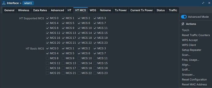

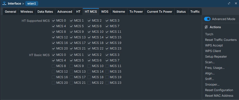

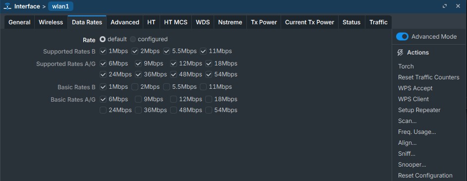

Hi, recently buy a SXTsq 5ax wich seems not to accept a fixed data rate. Given the support bot answer "it depends on specific models". Could anyone confirm if SXTsq Lite5 or SXTsq 5ac allows to configure a fixed PHYsical wifi data rate like 6Mbps or 12Mbps?.
Yes, devices with the old driver “wireless” have this functionality. a/g standart.
n standart
For the AC standard, you can only limit the maximum VHT speed to 0-7, 0-8, or 0-9.
Hi Ca6ko, thank you very much for your answer. So, as I understand, SXTsq Lite5 or SXTsq 5ac models have options for reducing to a fixed PHY WiFi datarate, correct?
