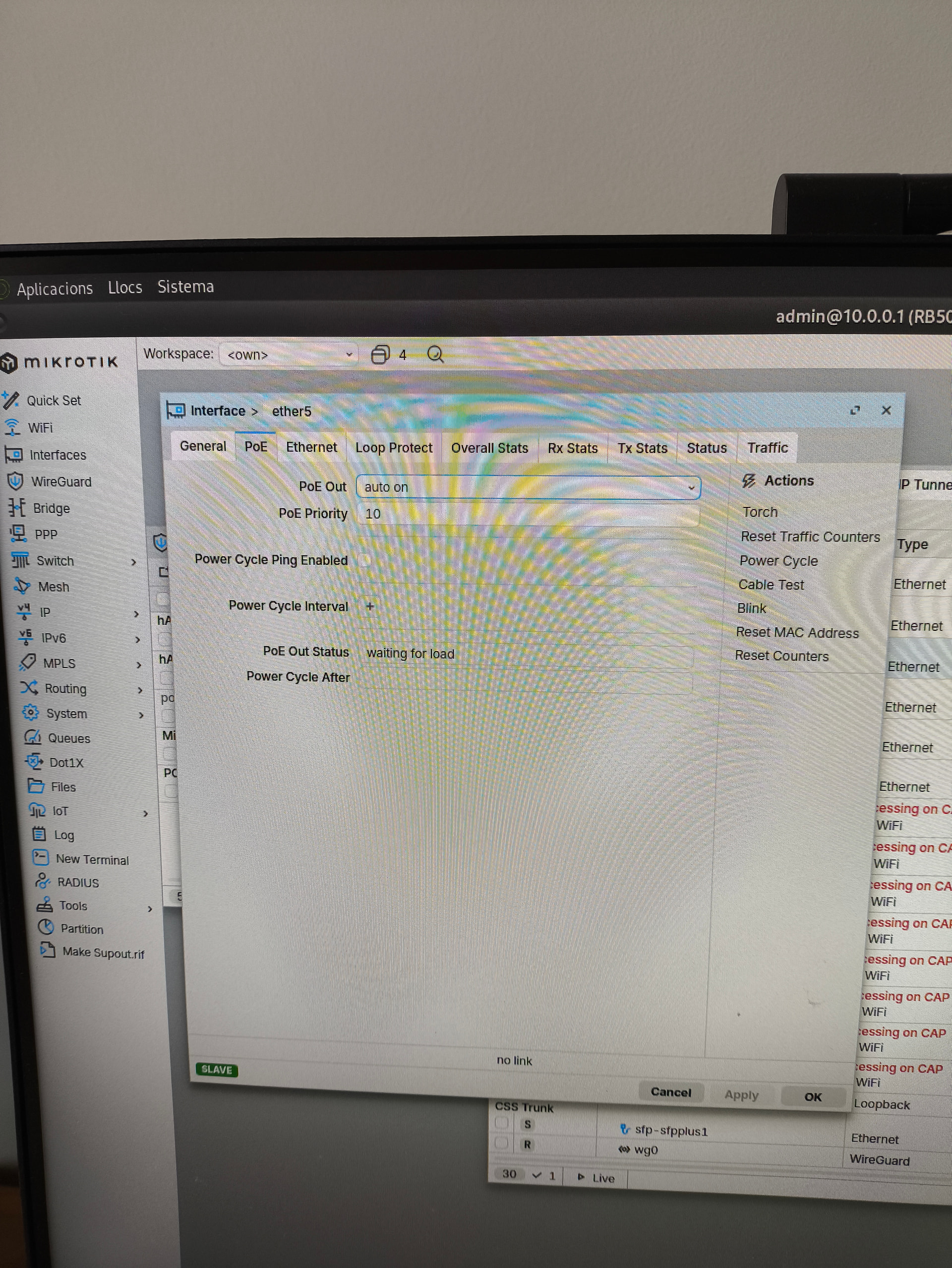

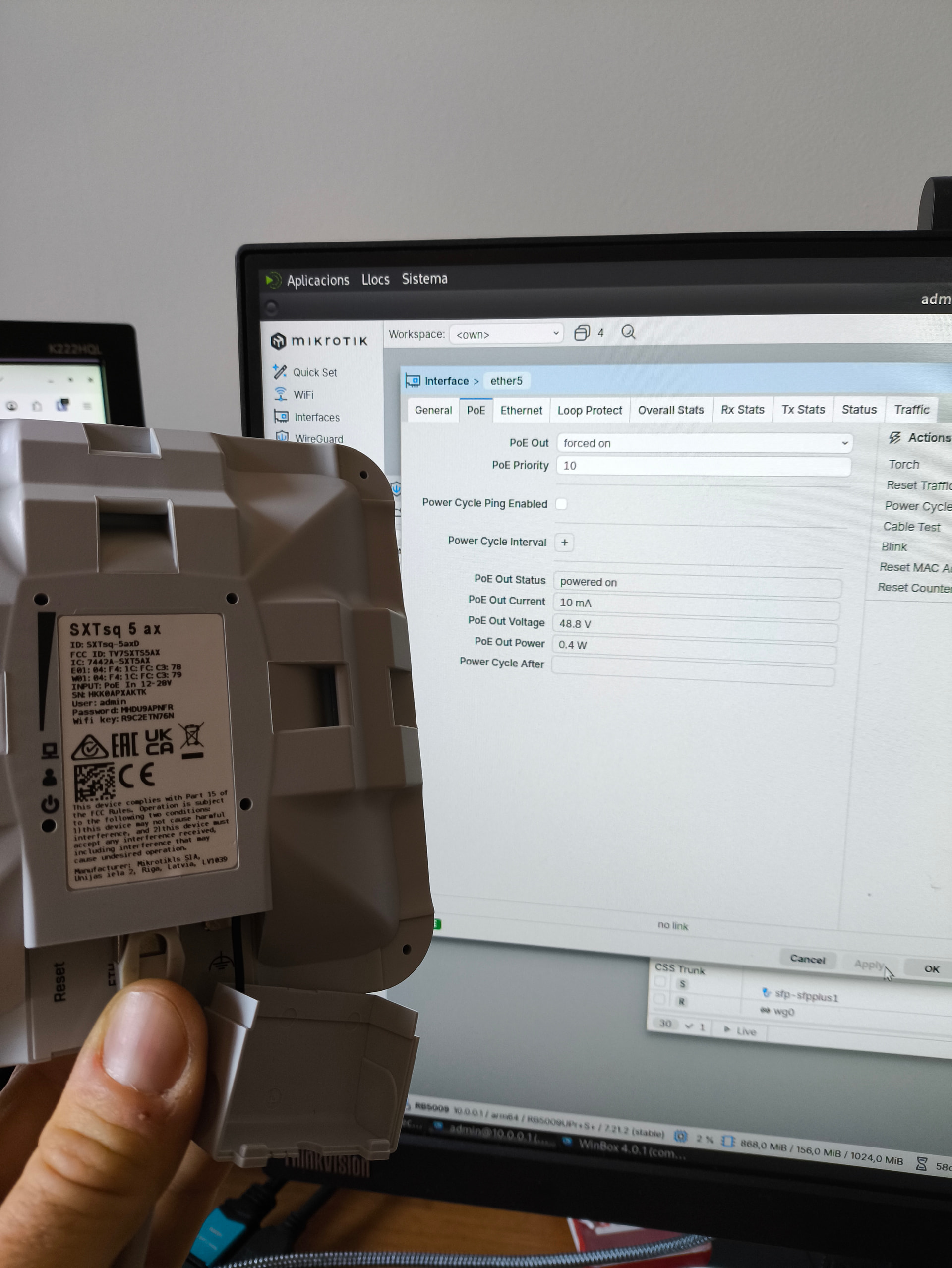

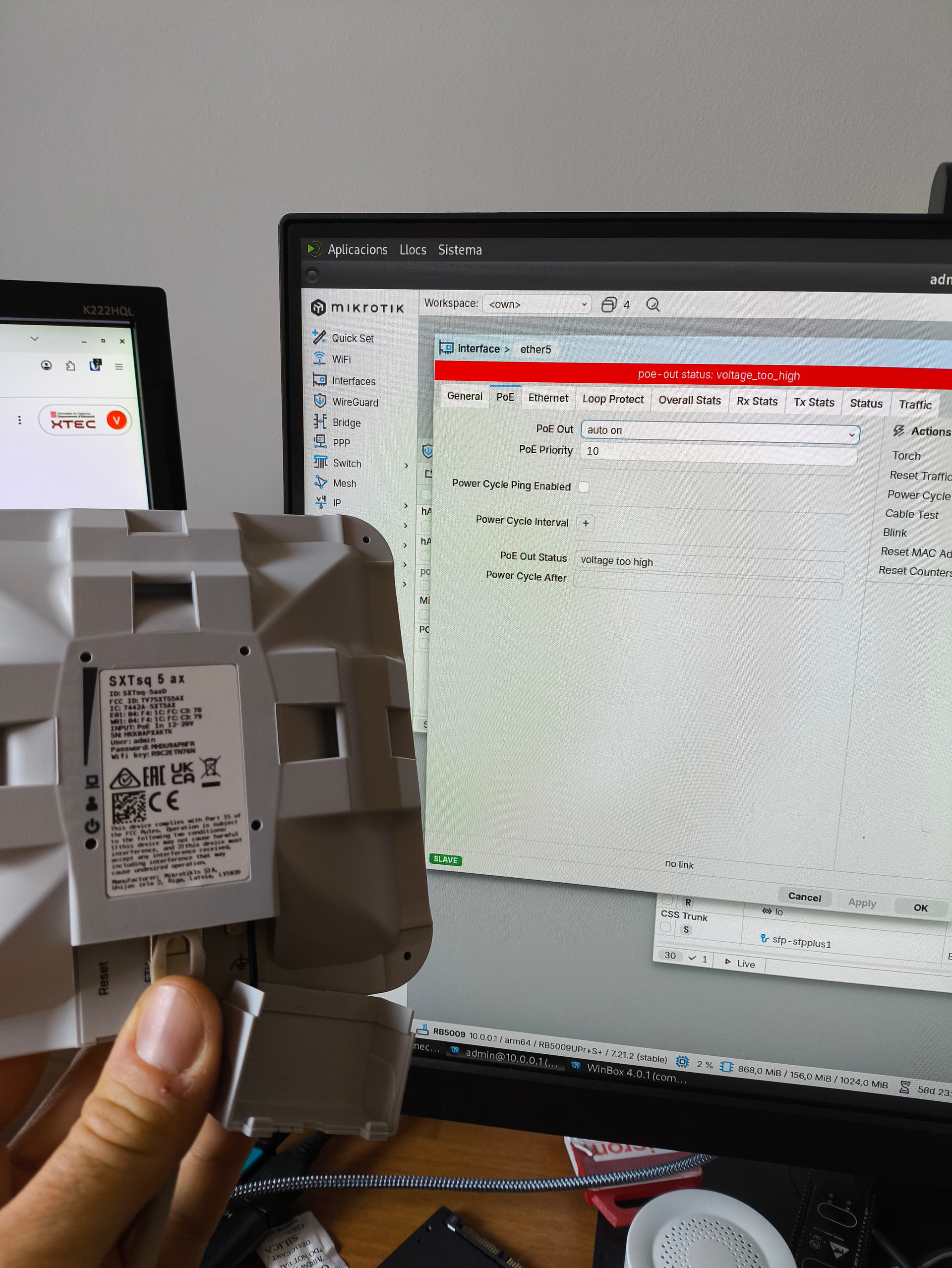

I recently buy a SXTsq5ax, all works ok, but at powering, if I connect directly to my RB5009, router show “voltage_too_high” and if I force POE I see that it want 48V. On datasheet say:

If you are powering the RB5009 at 48V, the PoE out is at 48V.
The SXTsq5ax wants instead 24V.
If you force PoE out on (@48V) the SXT won't like it.
You either power the RB5009 @24V or you use a separate power injector/PSU for the SXT.

Vast majority of PoE switches are like that. The ones supporting standard 802.3 af/at/bt require powering with 48V+ power supply, the passive ones may tollerate (or require) other supply voltages. All of them simply pass supplied voltage to PoE-out ports. The only negotiation between PSE (PoE switch) and PD (powered device) is whether connected device is actually PD (supplying power to non-PoE device can destroy that device) and power class of PD (which allows PSE to not provide power to PD which requires more power than PSE can supply).
The negotiation is never about voltage. The rare PSEs that are able to supply different voltages require manual setting of PoE-out voltage and it's only possible to select between voltages supplied to the PSE (either via multiple power supplies of different voltages or via built-in multi-voltage power adapter; none of PSEs I know have internal DC-DC voltage coverters for PoE use).
And as with any manual settings one has to be extremely careful not to set things the way it can cause damage (e.g. forced PoE on). And that requires careful reading of specs rather than wishful assumptions.
