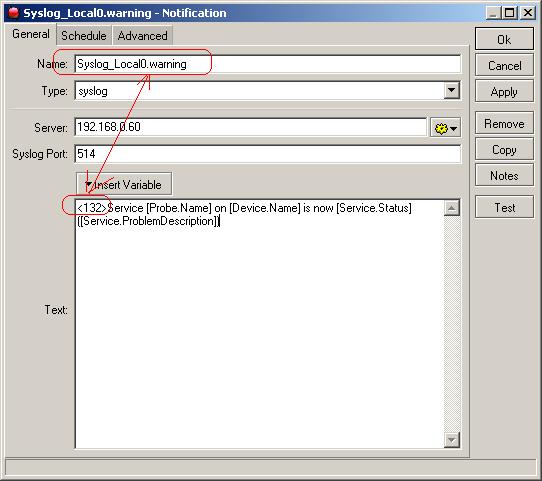

You can create custom notifications. For example
and this notification you can map to a service.
When the service will change the state syslog message will be generated and you will receive message on syslog server with Local0.warning, if you need to receive for example Local0.err for some services state change, you can create and map it to another service
when you configure notification for a service you can choose the notification type to send when the service state is changed
Is it clear?
works perfectly! thank you very much!
