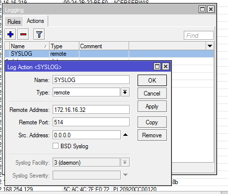

As copy of any message is send to SYSLOG so you can do
:log info “To REMOTE”
and it should be displayed in Log window and copy sent to SYSLOG target

In system\logging i create topics “info” with action type “remote” contains Remote Addres “my server addres” Remote Port “514”
