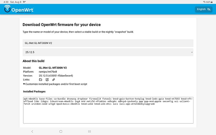

Who said Linux distro? I said OpenWRT which is embedded Linux as well for router/AP deployments, and the package management is NOT Linux - it's in OpenWRT itself . . . (Saw/used this on a GLINet Mango . . . Makes an AC2 look advanced!)
In that OpenWRT environment, you clearly CAN add modules to a flash based device without a full rewrite (heck, in a lot of cases, without even a reboot . . . so it's clearly possible.)
https://www.gl-inet.com/en-us/products/gl-mt300n-v2
(Also a 16MB devixe, although MikroTik gets a lot more features in that space than OpenWRT . . . )
You might want to read a bit more closely before you start talking down to people . . .
I tried to explain you how it works, not to get in a fight. End of my involvement.
You explained poorly, since the reality of the device I noted contradicts you completely . . . .
Every package noted is capable of being added/dropped individually (and that's just the base install) . . . and no Linux distro in sight. (The "how" is largely irrelevant . . . the point being that it is being done on an open platform, from whih MikroTik could borrow . . . )
Same 16MB flash architecture as MikroTik . . . they just found a way to do it. Perhaps they suck the FS image into RAM, modify and rewrite flash . . . Again, not terribly pertinent to my point. Even if ROS is a binany blob at thjs point, it still needs to load to run, and a direct image vs. a compressed image may change the mechanism, but not the result, but yes, there would be other work to do, obviously.

followed by a openwrt screenshot.
pe1chl described how routeros package management works. You, tadawson, keep on talking about openwrt.....
Yet another one who cannot read, apparently (or just enjoys bashing too much . . . ) I said that OpenWRT had mastered fragmenting it's features, and was an open platform, so that if MikroTik wanted to do something similar, it a) has been done on similar hardware, b) Is definitely possible and c) Is open source, so they would not need to reinvent the process. I offered a screenshot to verify what I had stated. That's it.
It had absolutely nothing to do with what MikroTik is currently doing. It was purely about what they could be doing, and the precedent set by others.
What part of that did you not get? It was SUPPOSED to be an OpenWRT screenshot, showing it being done, despite the off-topic, unrelated, irrelevant spew about Linux distros from others.

Well, the actual OpenWRT firmware selector is very useful.
It is almost impossible to use without a lot of patience and some knowledge (please read as a lot of research), but it allows to "tailor" an image to the exact intended uses of the device.
The default choices are (IMHO) largely "wrong" (though I understand how they try to be a "good for all" compromise) but having the tool available solves a lot of headaches connected to compiling or re-compiling.

It was relevant to the 16MB limit, excess features in RouterOS and possible ways to improve that situation, as well as to show those saying it wasn't possible on flash based devices a case of it being done (and open source).
