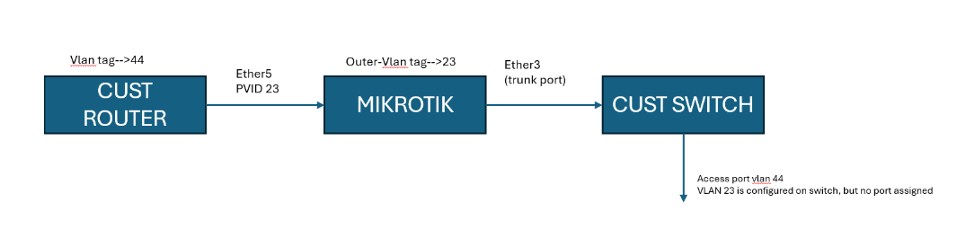

I am fairly new to the MikroTik world and RouterOS. I am trying to configure a bridge with tag stacking. Below is my network diagram.
I have tagged packets coming from another router to MikroTik, and I am not aware of what tag they use (for this case, let’s say the tag is 44). I am trying to perform tag stacking by adding an outer tag of 23 and passing it through my trunk link to a customer switch. On the customer switch, both VLANs 23 and 44 are configured, but the client is connected to an access port with VLAN 44 as the inner tag.Am I missing something, or do I need any additional configuration
add name=bridge1 vlan-filtering=yes ether-type=0x8100
add bridge=bridge1 interface=ether3
add bridge=bridge1 interface=ether5 tag-stacking=yes pvid=23
/interface bridge vlan
add bridge=bridge1 tagged=ether3 untagged=ether5 vlan-ids=23
