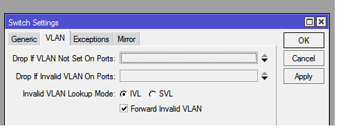

keep in mind unless you uncheck forward invalid VLAN you cannot verify your VLAN filtering
