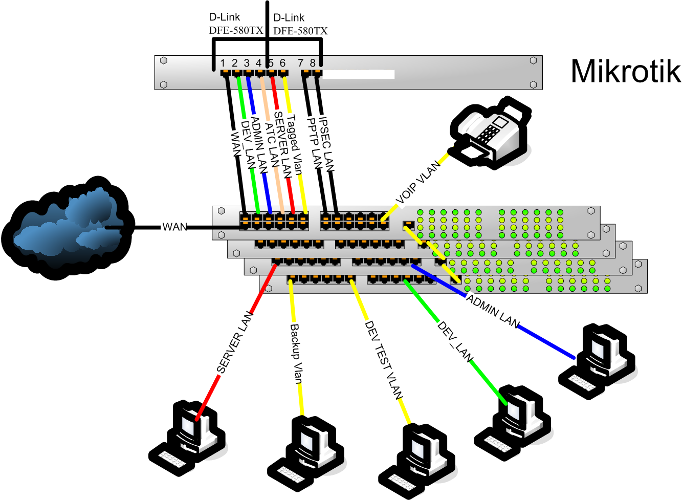

my mikrotik router is a 1,8ghz amd pc with 2x D-Link DFE-580TX (4x 100Base-TX, PCI)
router os 2.9.17
my switches are 6x Zyxel GS-2024
i have now 7 vlans on this switches and i ned 3 more but i have only 8 interfaces on the router.
how can i use one physical interface for more vlans?
i’ve tried to create on one physical interface (interface 6 @ image) a vlan interface with vid=60 & name=dev-test mtu=1500
on zyxel i’ve tagged the port 6 on wich the router is connected… but no ping to clients in vlan 60..

the router is conected on switch 4 with port 1-8

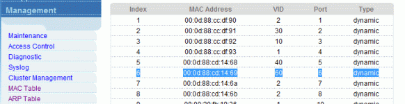

i’ve found this (see image)
check this an all switches
yes all vlans are working on this switches… but the connection between switches and mikrotik didn’t work!
