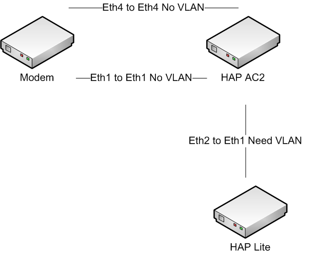

This my current setup, both Internet & IP TV connection from modem and it doesn’t have any VLAN tagging. I can’t change anything on modem because it from my ISP.
I’m looking for any possibility to tag connection from IP TV and pass it to HAP Lite with my Internet.
