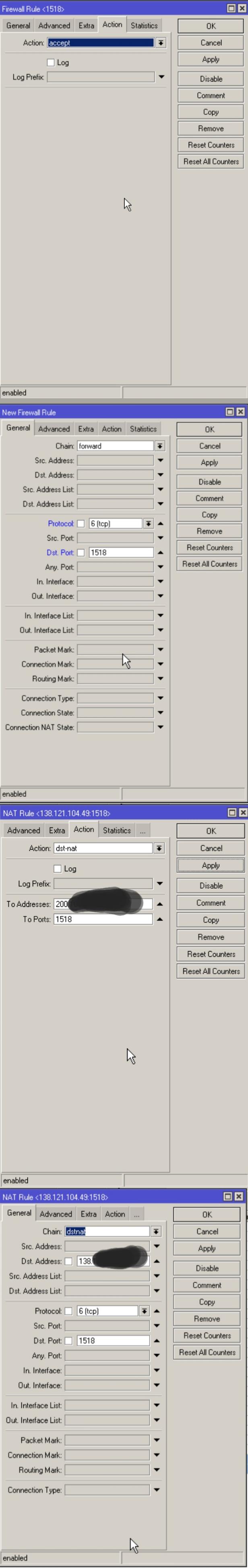

Good afternoon. I set up packet forwarding for incoming packets on x ports to other external IP addresses via NAT. There were no issues with UDP, but TCP isn't working. Just in case, I loaded rules in filter rules, but TCP still isn't forwarding.

Thanks for the reply, screenshots attached.
If both these 138 and 200 addresses are on the WAN side of the router, I don't think DST-NAT can help you. DST-NAT assumes both are on the LAN side so that it can provide a fiction to the WAN side.

Also, your attempt at redacting the screenshots was incomplete. You would have had better luck sanitizing /ip/firewall/export output, which would also have been easier to read and think about. Hint.
Thank you very much, taking into account what you told me, I created a rule in NAT with chain srcnat, out interface wan, and in action masquerade, and there the ones I had created worked without problem.
