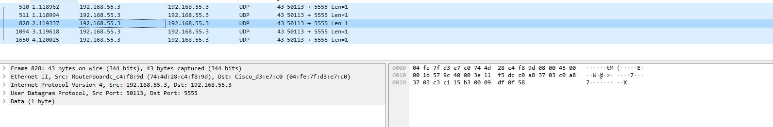

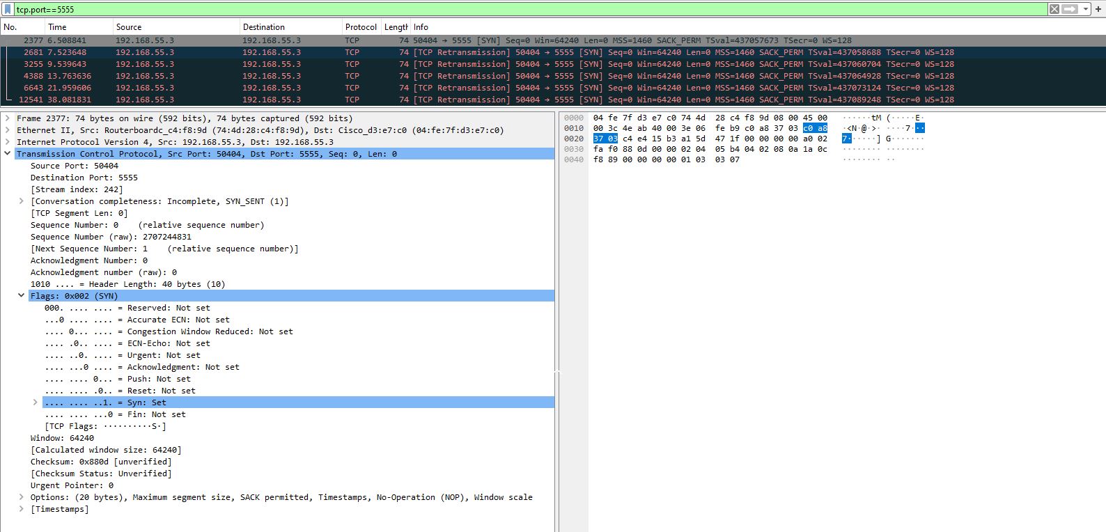

Ok, I decided to bring the “big guns” and captured everything while testing port forward.
UDP port forward looks like this (and works fine):
TCP port forward looks like this and NOT working correctly:
Unfortunately, while I understand that something is wrong, I don’t understand what exactly is wrong and what prevents it from working normally.
If you understand WHAT it wants and WHY it keeps retransmitting please let me know.

P.S. I’m testing port 5555 with “nc -z -v -v -t mydomain.com 5555” - not working.
UDP with “nc -z -v -v -u mydomain.com 5555” works fine.
Any other port behaves the same way.

From my observed behavior it looks like I have SYNs working ok all the way, but it never gets the corresponding ACK back.
What are the conditions for this to happen?
  1. Incorrect Gateway setting (in my case GWs are set correctly for all the involved subnets)
  2. Interface section of dstnat rule is messed up.
  3. Interface section of masquerade rule is messed up.
    In my case the dst VM (and the entire subnet) is behind another Cisco L3 router. Apparently, the UDP and TCP routing works very different - this caused the most confusion.
    UDP packets goes all the way outside and then come through WAN on ether1. But TCP tries do do everything internally, and if the check is initiated from the inside it never leaves the internal network.
So my rule:
add action=masquerade chain=srcnat out-interface=ether1 src-address=192.168.55.3
is not working, because TCP packets never goes through ether1.
The correct working rule is:
add action=masquerade chain=srcnat src-address=192.168.55.3
This way it works no matter what. (and also very fast too).
