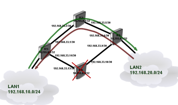

Using this example:
https://wiki.mikrotik.com/wiki/Manual:Simple_TE
About Failover Testing, MikroTik already says:
“Note: Switching from primary to secondary path may not be as fast as expected. It depends on OSPF dead timeouts, routing table updates and timeout settings in TE tunnel configuration.”
Just i need your experiance how long does it take? in my case it takes 2 min :slight_smile:
2 mins is realy alot.
Can you add bfd to your setup and share results?
By enabling BFD or reducing OSPF dead interval
and
setting lower TE reoptimize interval and primary-retry-interval
@mzar
I’ve done that,normally how long do i need to expect,approximal?
