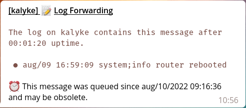

I have a script/module to Send notifications via Telegram. If notification can not be sent it is queued and sent later. Is that what you want?
The message looks like this when coming from queue…
This one was sent by Forward log messages via notification.
