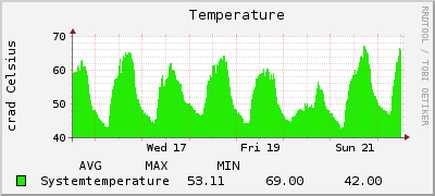

We had a lot sunshine today, finally some summer in Europe.
I noticed grooves having a temp of 68 C. Such devices are mounted at a pol on to of a roof so they get “burned” from the sunrise to the sunset.
UPDATE
Here also a sample temperature-graph from on of the groove
Wow toasty, it was 104f at the end of last week and mine didn’t break 115f
