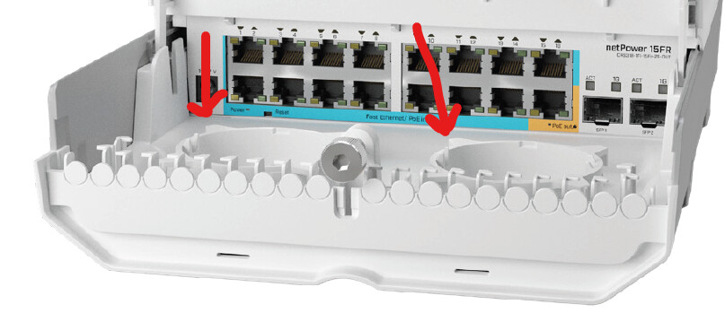

IMHO for outdoor boxes like this, Mikrotik should /really/ integrate a small 4 slot tray for splices.
But there are already 2 splice mounting elements. Just end the FO cable with connector and insert it directly into SFP module. There is not much place free left when you connect all 16 USFTP567 (chose proper standard combination) cables.
