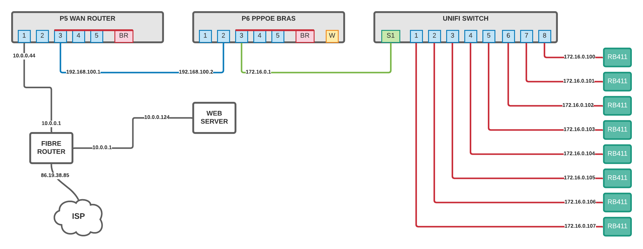

This is my current setup:

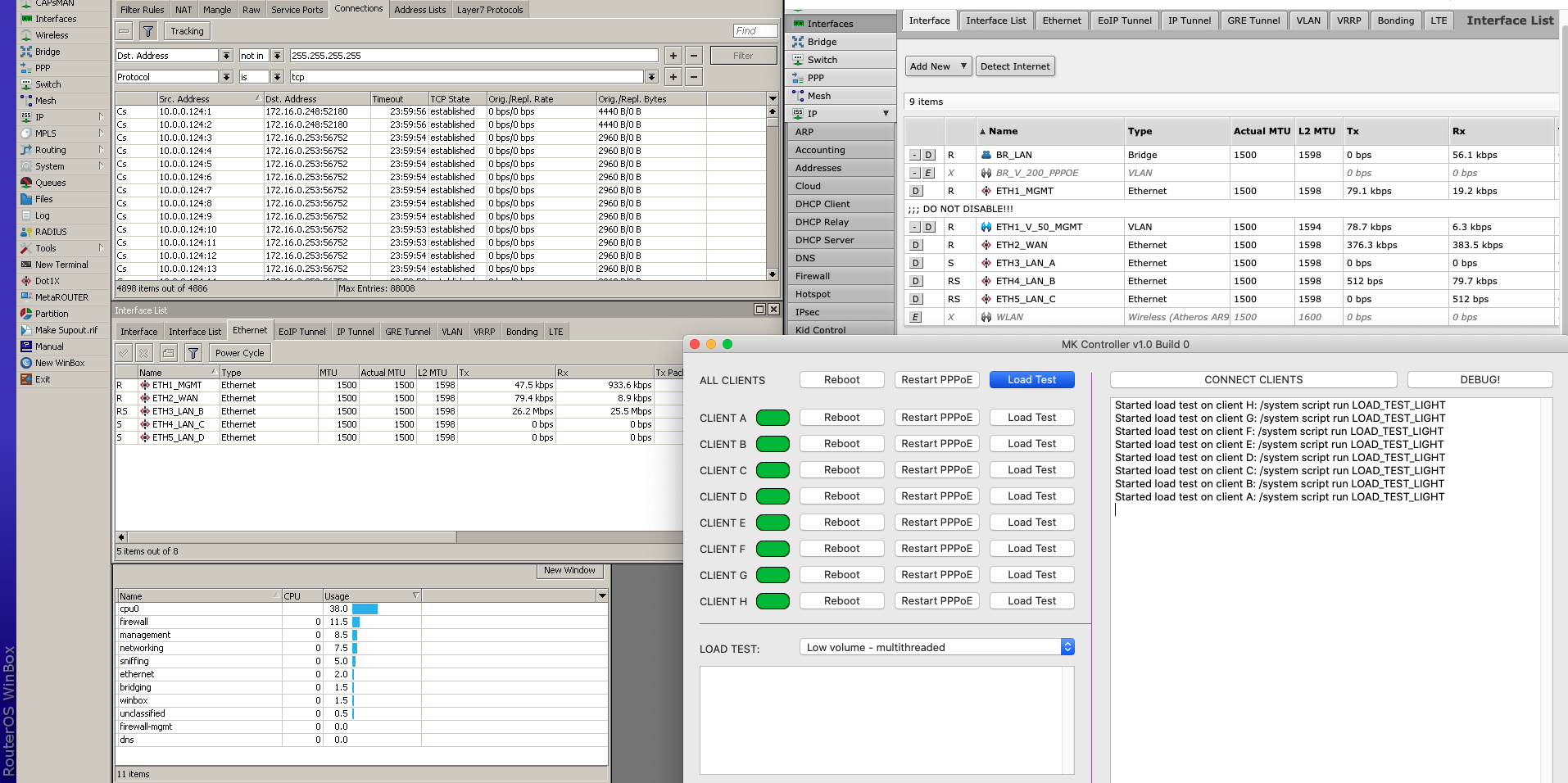

And this is the “command window”:
Explained: Winbox on the left is the NAT router, showing connection tracking with broadcast crud filtered out, interfaces, and CPU Profile tool. Top right is the BRAS, with 8 PPPoE clients at 4Mbps rate limit (with 5Mbps burst). These 8 clients are the RB411s, remotely controlled via a simple app I’ve written, which can run a variety of load tests on individual clients or all at once. The load tests revolve around downloading a 5MB .zip file from the web server in the diagram above.

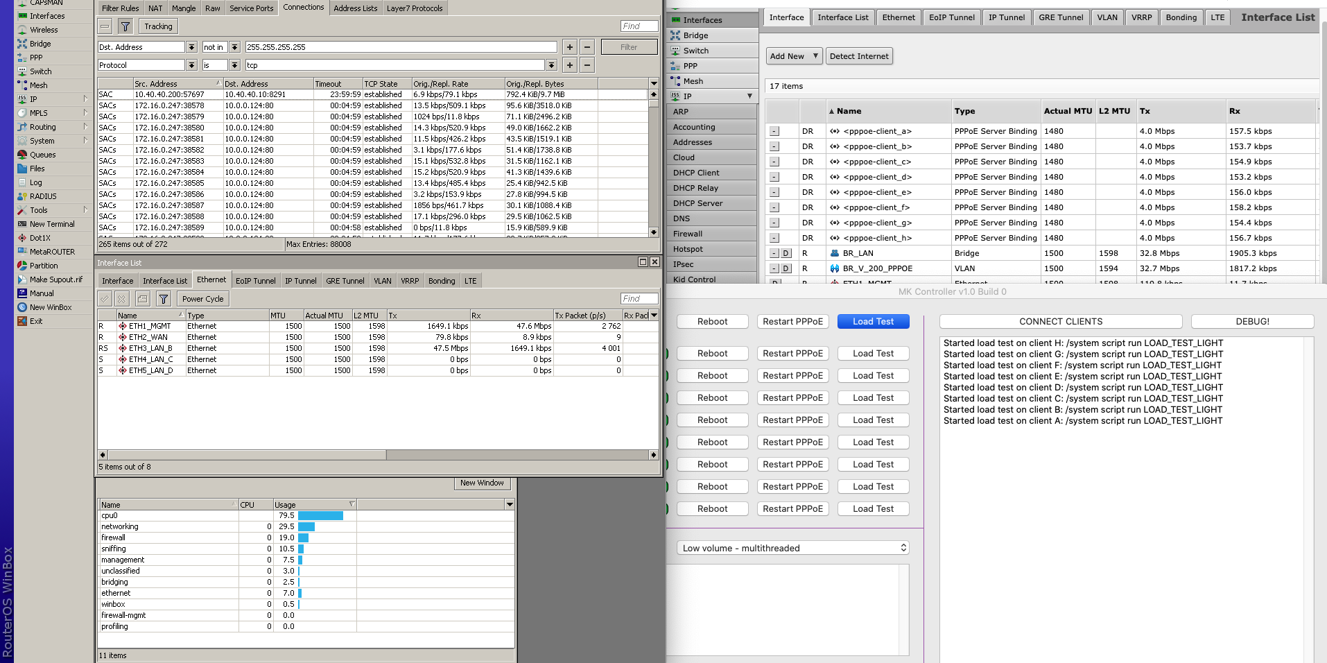

Steps to trigger the issue:
  1. Start a parallel download load test, where each client downloads the .zip file multiple times in parallel via fetch tool. This is what we see while running:
We can see that connection tracking captures a number of simultaneous connections from the clients on 172.16.0.X:Y to 10.0.0.124:80. So far so good. We can also see CPU load is quite high, which is expected.
  1. Disable the PPPoE interface on the BRAS:
The downloads stop, but almost immediately, thousands of tracked connections are built up on the NAT router, all of them with the maximum expiry time of 1 day (the default Mikrotik setting). These connections all come from the web server on 10.0.0.124, but with increasing source ports starting at 1, all aimed at the addresses of the PPPoE clients which are now “dead”.

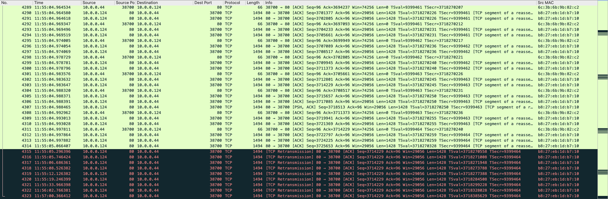

I captured a trace of this event, and it shows a flood of ACK packets from 10.0.0.124 sourced on increasing ports, starting at 1. Wireshark decodes the ACKs on port 123 as NTP, port 139 as NetBIOS, etc. Of interest is that the source and destination MAC addresses change in the three retries per ACK, first packet is from NAT router MAC to BRAS MAC, the other two are from BRAS MAC to NAT router’s MAC:
Source	Source Port	Destination	Dest Port	Protocol	Length	Src MAC		Dst MAC
10.0.0.124	1	172.16.0.253	56633	TCP	1494	6c:3b:6b:9b:82:c3	b8:69:f4:12:69:53
10.0.0.124	1	172.16.0.253	56633	TCP	1494	b8:69:f4:12:69:53	6c:3b:6b:9b:82:c3
I can share the full pcap dump if someone wants to dig into it, but it’s basically 1000s of the above, with source port increasing by 1 on each try.

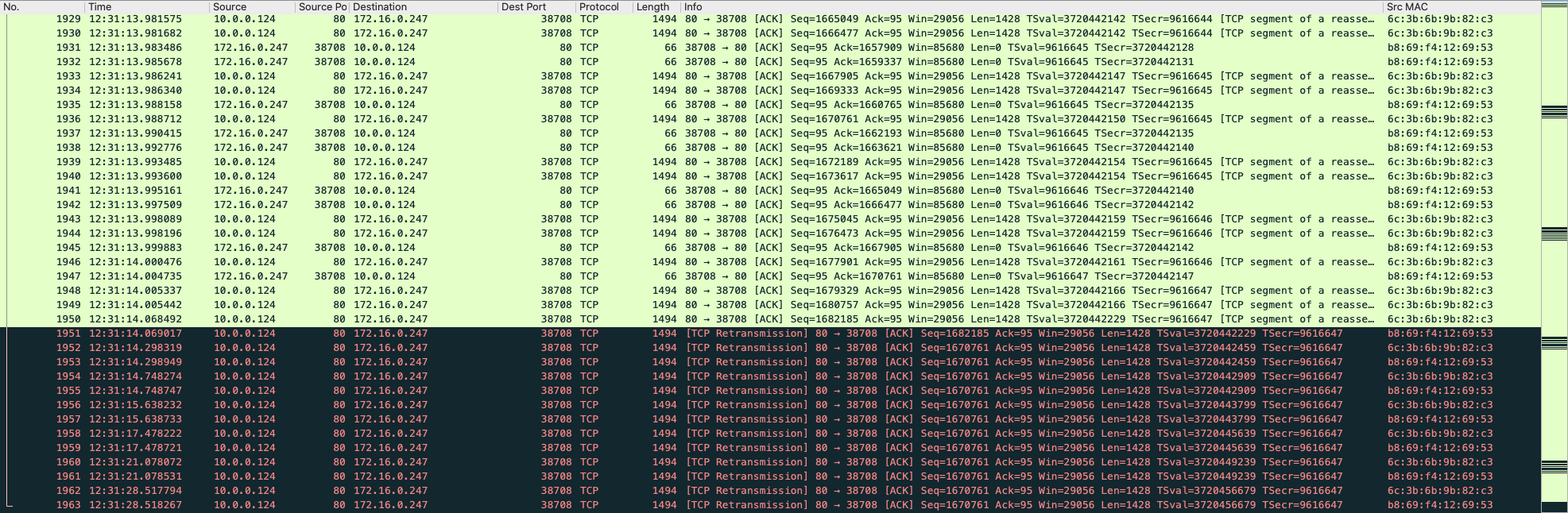

When the link is cut off, the web server tries a few retransmissions before giving up.

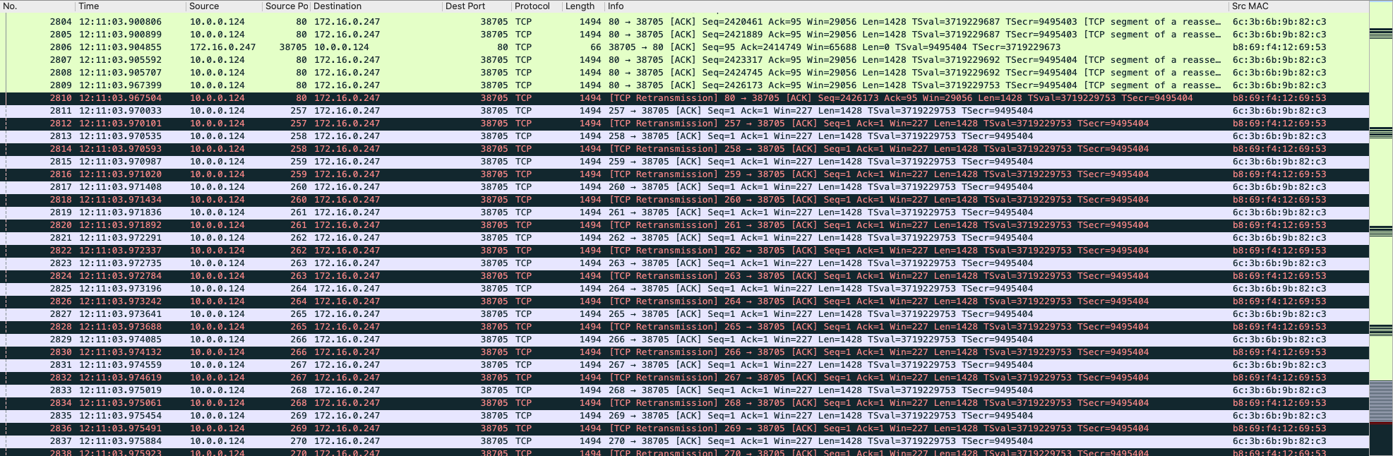

On the NAT router, this is what’s captured on the upstream interface, the one facing 10.0.0.124 which is the webserver, and which has 10.0.0.44 as its own IP address:

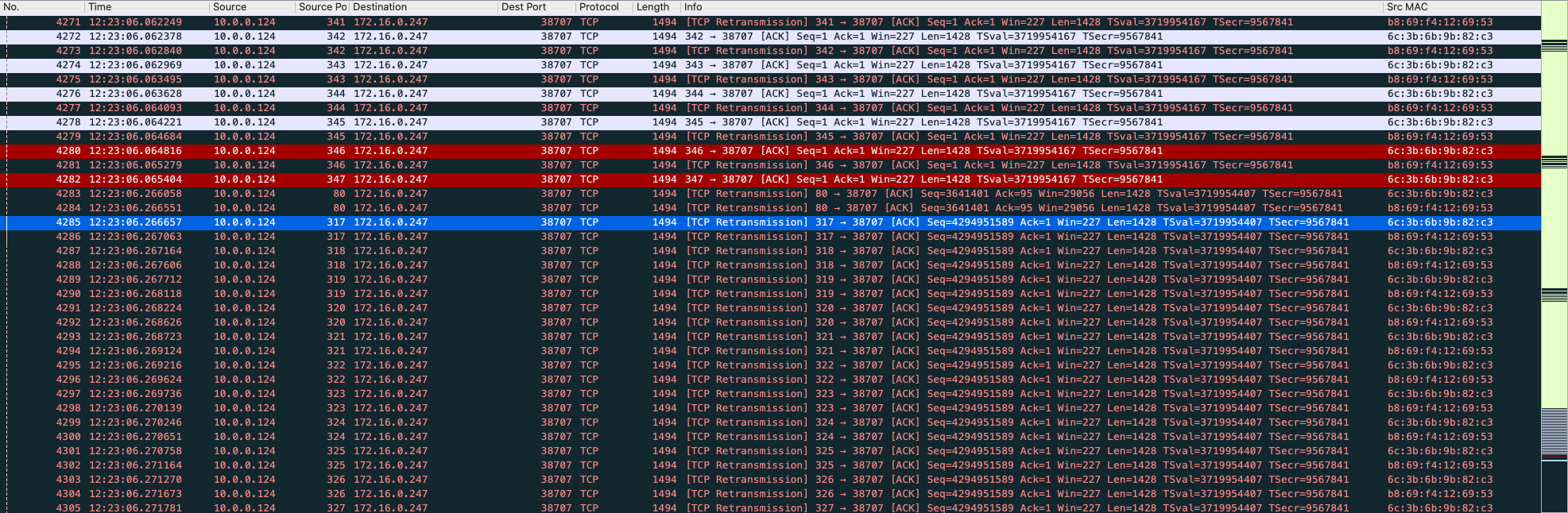

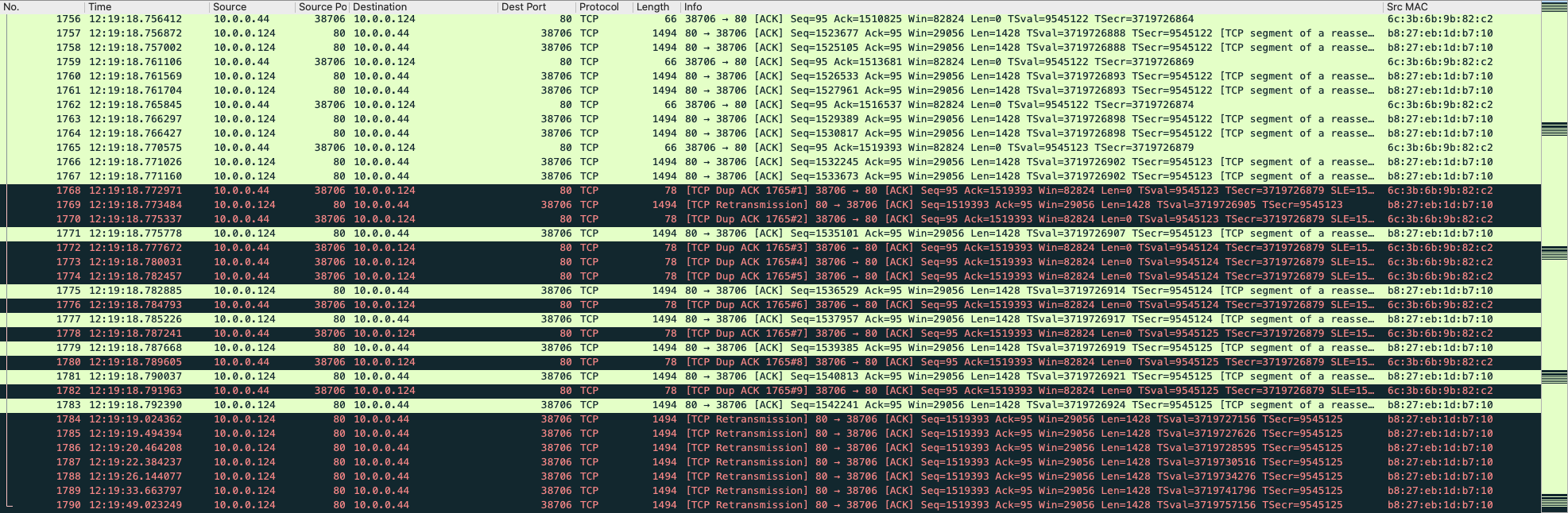

Again, all normal, matches what’s seen at the web server. If I sniff on the bridge interface of the NAT router, where the BRAS is connected to, we see this:
followed by a boatload of retransmissions of the same ACKs:

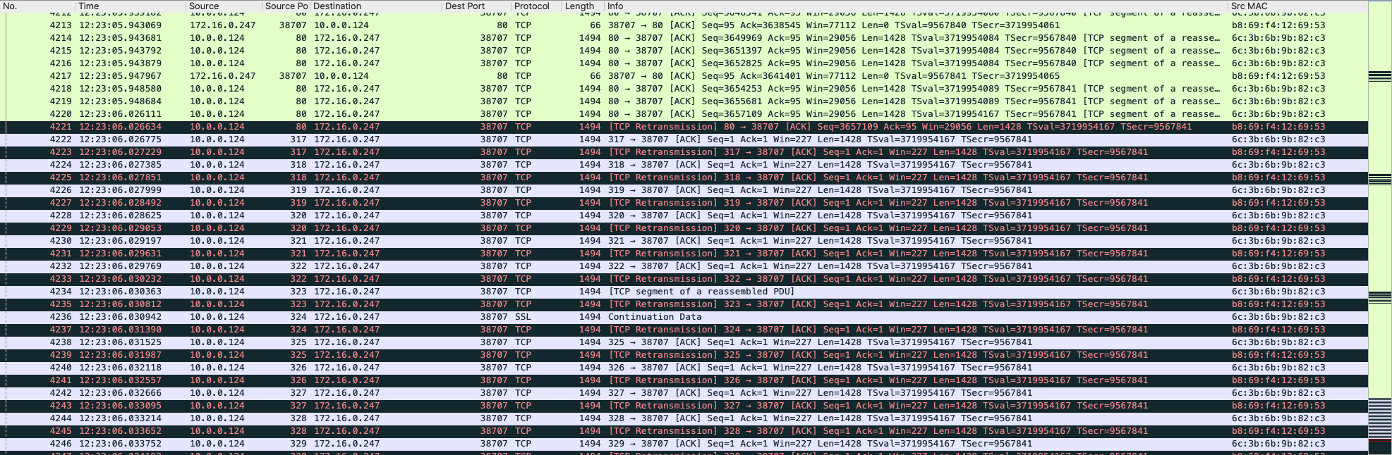

If I filter by e.g. port 317, one of the “random” ports supposedly chosen by 10.0.0.124, we see one ACK followed by 13 retransmission attempts. This is what the BRAS sees, as captured on the upstream WAN interface that’s facing the NAT router’s bridge:
It seems quite evident that the ACK packets are actually hitting the BRAS, coming from the NAT router.

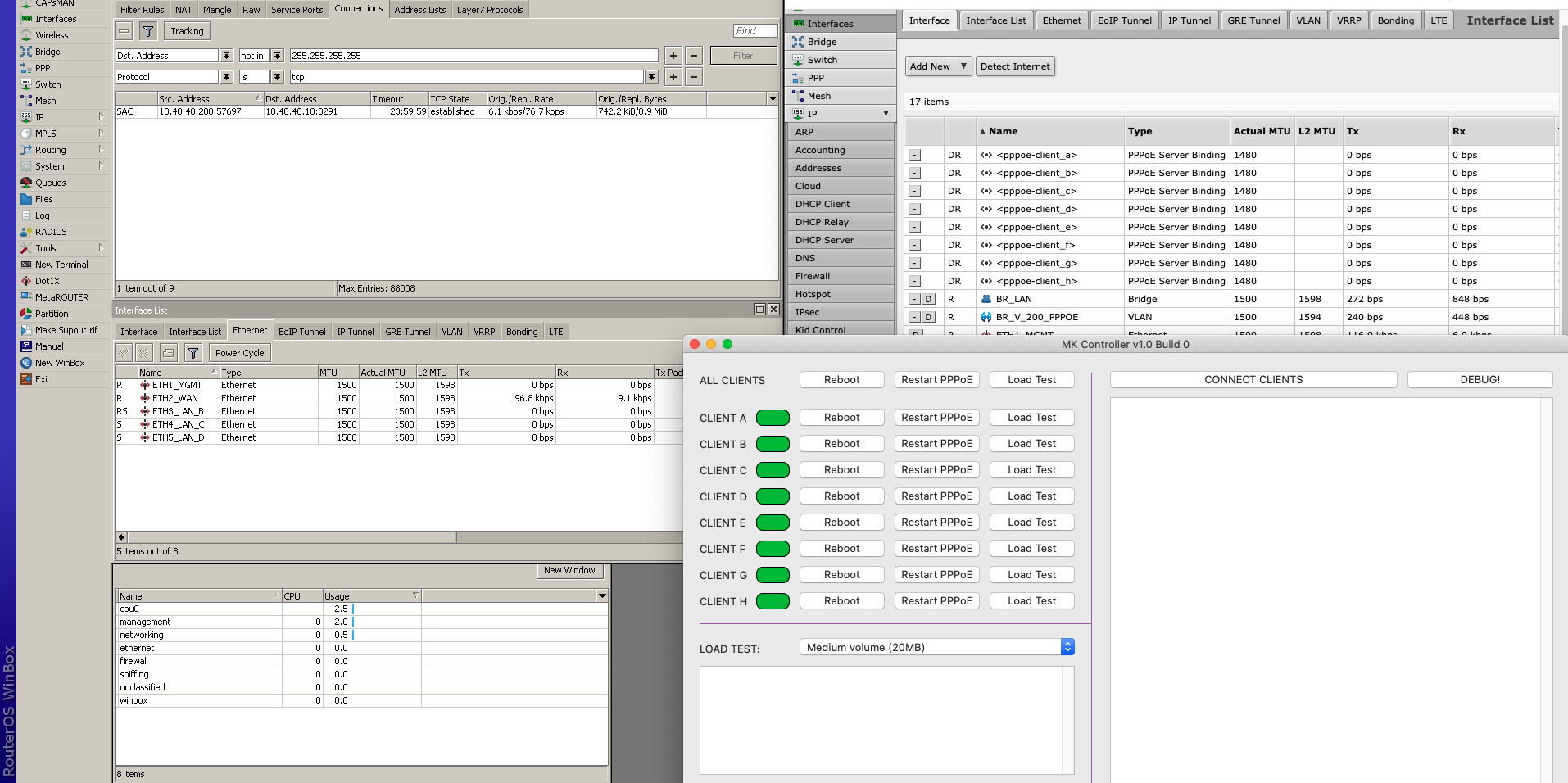

I can confirm that if I disable loose TCP tracking, the “phantom” connections do not take place, there are no ACKs from random ports, etc. It all looks “normal”, and only the tracked connection from 172.16.0.247 (the PPPoE client) to 10.0.0.124:80 remains on the connections table, with an expiry timeout of 5 minutes:
The hard question is how can anything be generating “fake” packets with increasing port numbers in such massive numbers, and in response to what? I am proper stumped!
