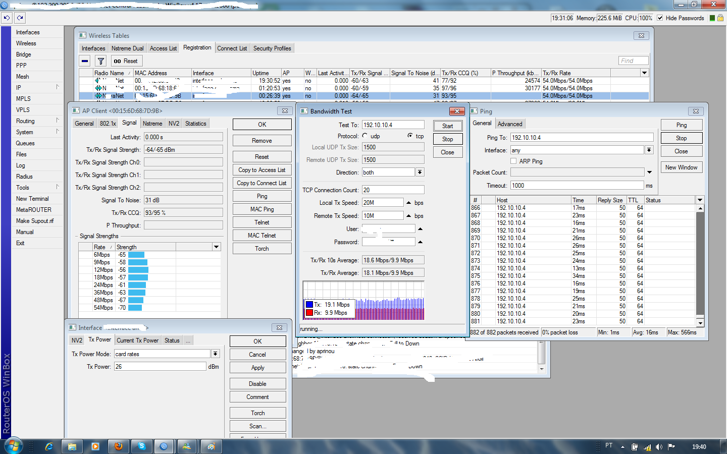

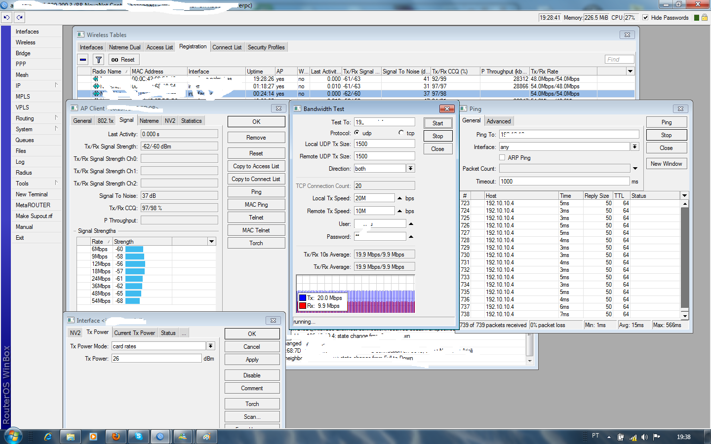

Test NV2 40Km
In this test we did a 40 km link using NV2, we tested all he does better on top of Nstreme in terms of latency and processing continues over TCP using 100% CPU, no ping traffic ranges from 5ms to 24ms, we also realize he has remained online with no fall maximum of 1 day by setting the same power. As you leave the bridge even in common is swinging up to 5 days without anything, we Hw. Retries = 10, NV2 = 2 TDMA Period Size, Cell Radius 40Km, XR5 card, TX-POWER = 26dB.

Our testing was done using only one card XR5, Pluton Antenna 5.8 Ghz 29 Dbi produced in Brazil.

As friends and talk suggest we use this test to publicize the system funiona, as this link does not require more than 8Mb, used it as a test to get an idea, of course I want to use N cards and see how it comes that and link distance, more like Mum saw in Sao Paulo Brazil who speak more than 30Km NV2 did not run and was very poor, I decided to take the test using the worst case, a single card set optimally and do the tests, we use 26dB I think the test was a success when it comes to hardware used and the form used.
As mentioned we use version 4.17 because it ran Mpls, and still not test it on as versions 5.8 and 5.9
