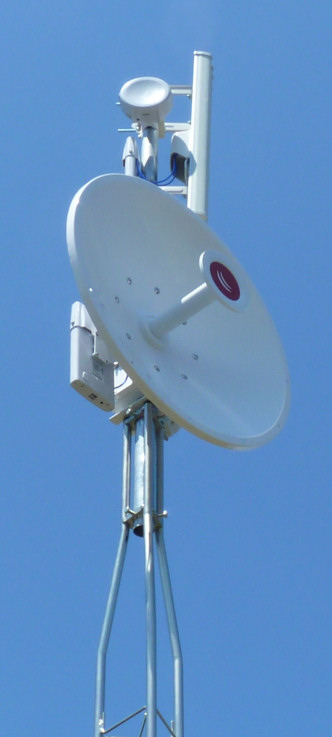

I have just finished to assembly on lab MTAD-5G-30D3-PA dish with flex-guide (included) and BaseBox5.
Ubiquity rocket dish are easily assemblable than MTAD-5G-30D3-PA [the only problem on MikroTik dish I found is excessive white paint on two hole, but easily fixed with one screwdriver],
but MikroTik mount system are more professional under all aspect…
Thank you for the compliments. A lot of work went into the RF design and you should also see an improvement over competitors models because of the port to port isolation and true gain.
Future versions will have a slightly bigger box and more will be pre-assembled at factory.

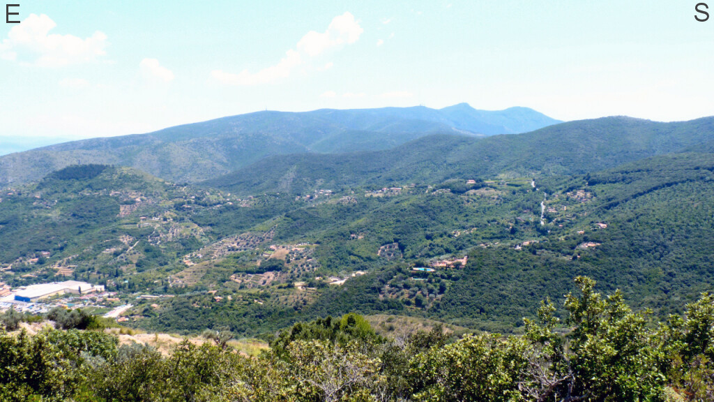

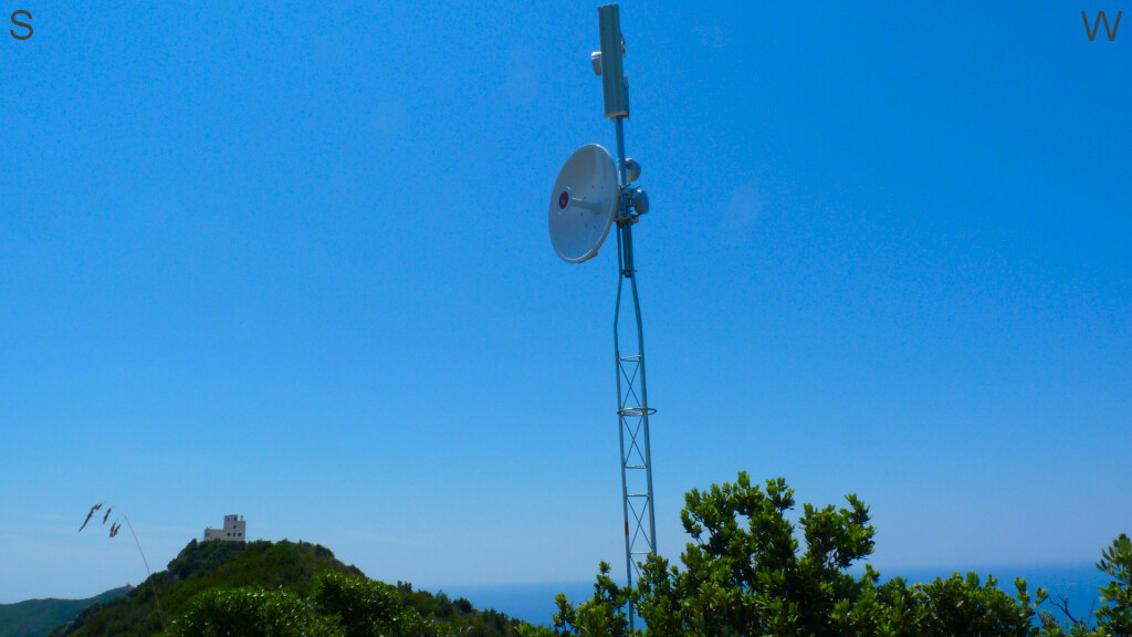

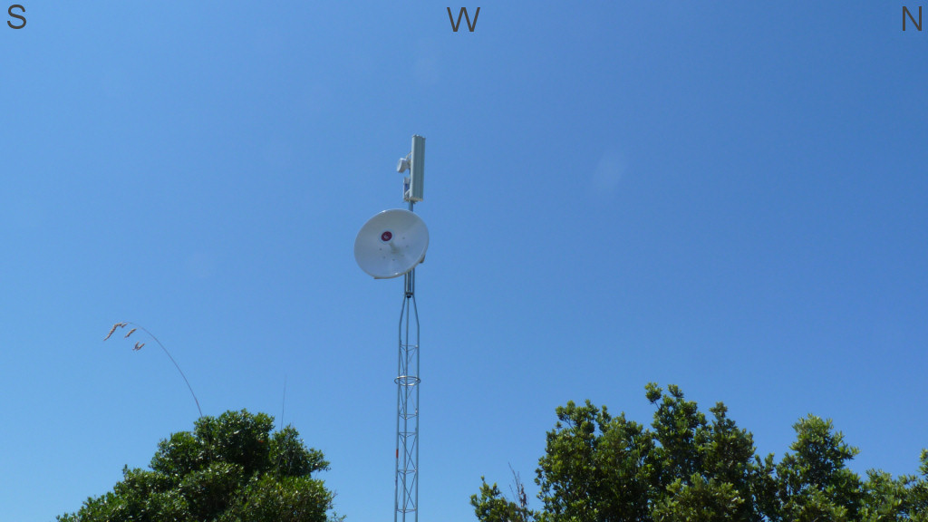

Photos of the directions (not really the exacts) where panels are pointed.
The photos are not made on the pole, but at the base.

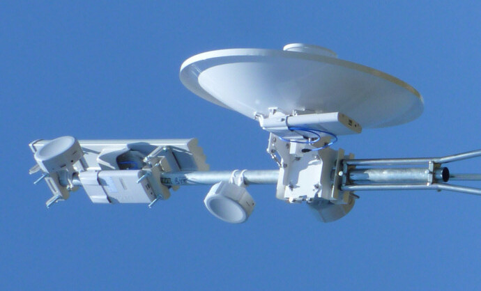

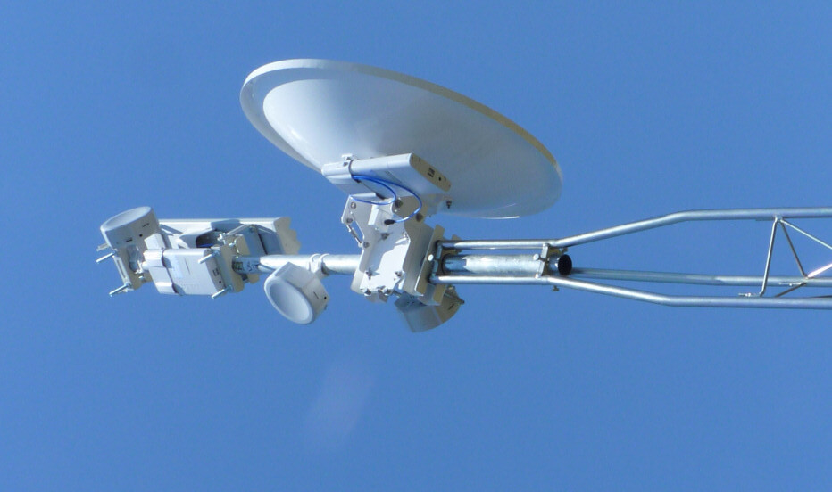

And this some zoom on devices (obviously ethernet cable are missing!!!)

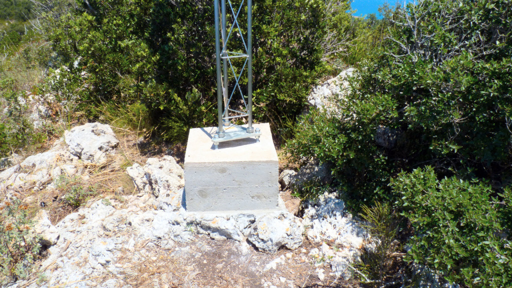

The base of the pole are fixed on the rock by 10 stakes of steel 40cm long fixed with chemical resin.

When I go to put cable and solar panels, I put also some bracket for tilt the SXT-SA, I forget that at the lab…
