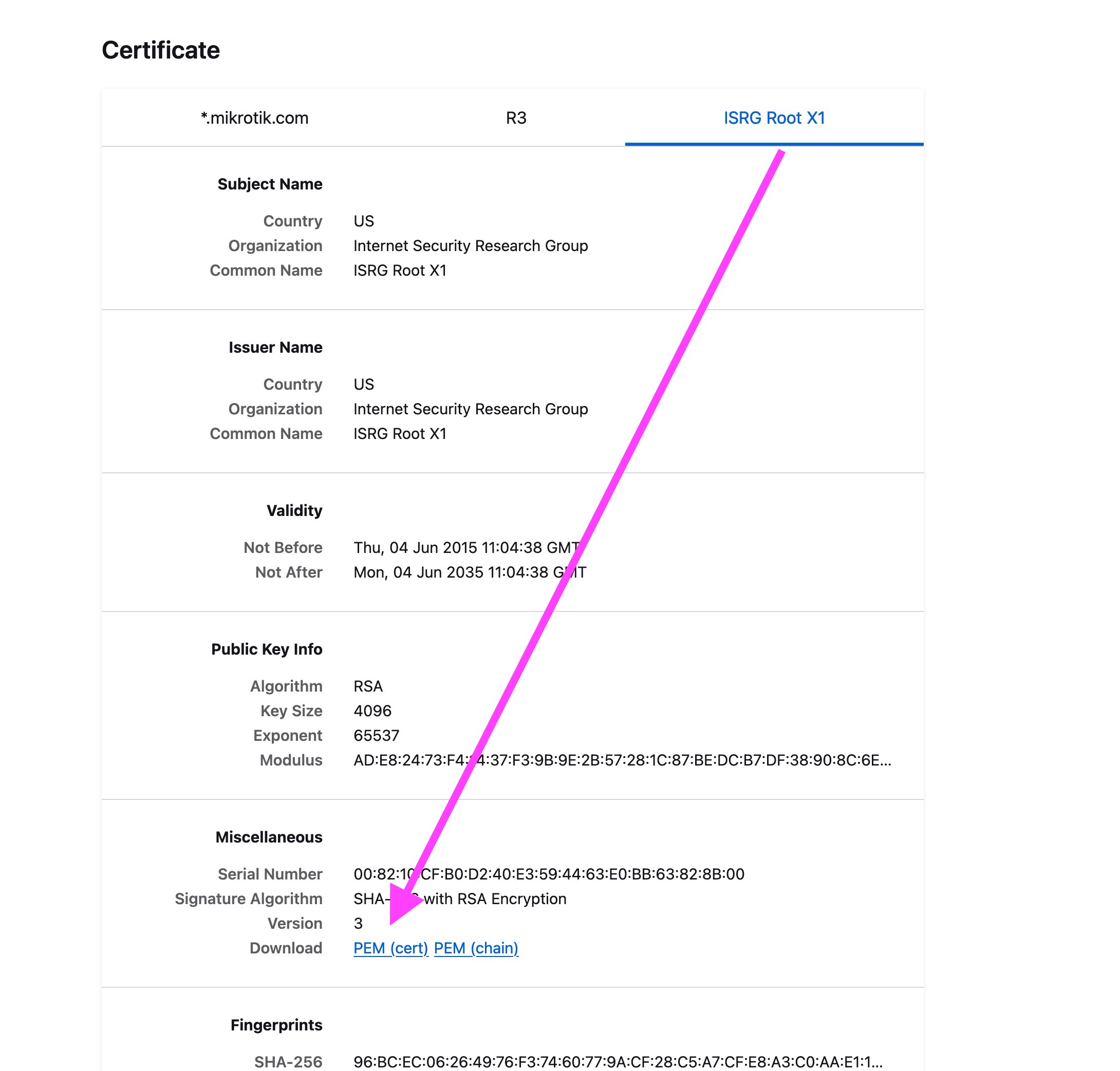

  1. Use Firefox (always, as a general recommendation)
  2. In Firefox open the blocklist link, that you are going to be importing, for example https://raw.githubusercontent.com/StevenBlack/hosts/master/hosts
  3. Click on the Padlock icon in the address bar, Connection Secure → More information → View Certificate
  4. Download the root certificate and import it in the router
The https://github.com/ imports for me
The https://raw.githubusercontent.com does not
If you are importing the root certificate, it does not matter. Try and see if it works
