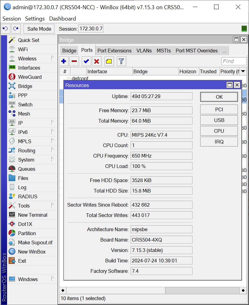

Did you use vlan in your configuration? I can’t get vorking config on it on CRS504
vlan 887 → qsfp(tagged) → bridge (tagged, vlan filtering on) → vxlan887(untagged) → other side of vxlan.
Can’t see traffic on Vxlan interface with any HW settings in switch :frowning:

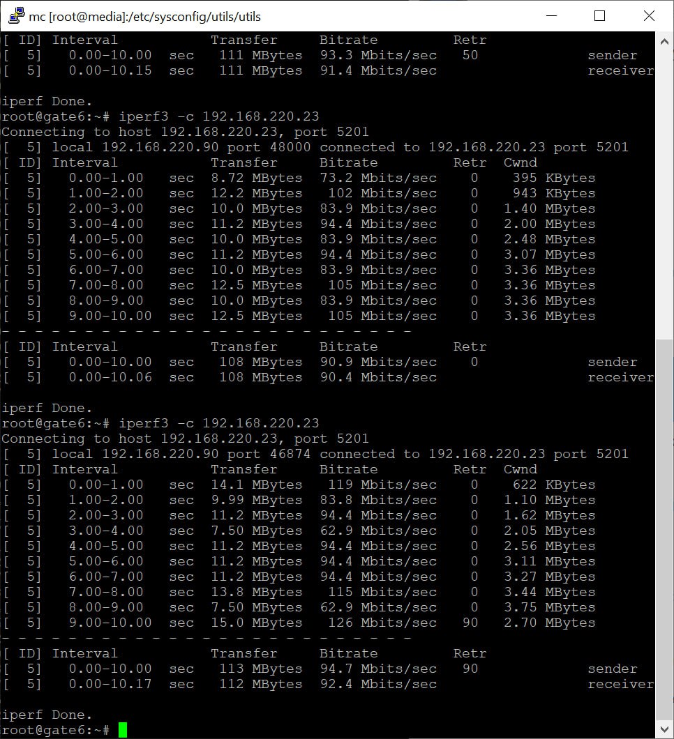

I have tested the same configuration on previos version of RouterOS software, it was worked, but with 100% CPU load and depressing performance about 100mbps. We need vxlan to link clients vlans over L3 network. Now CRS2004 routers do it much better, but EoIP tunnels gives twice performance over than Vxlan there. Hope only for HW support on mikrotik switches with vlan support.
