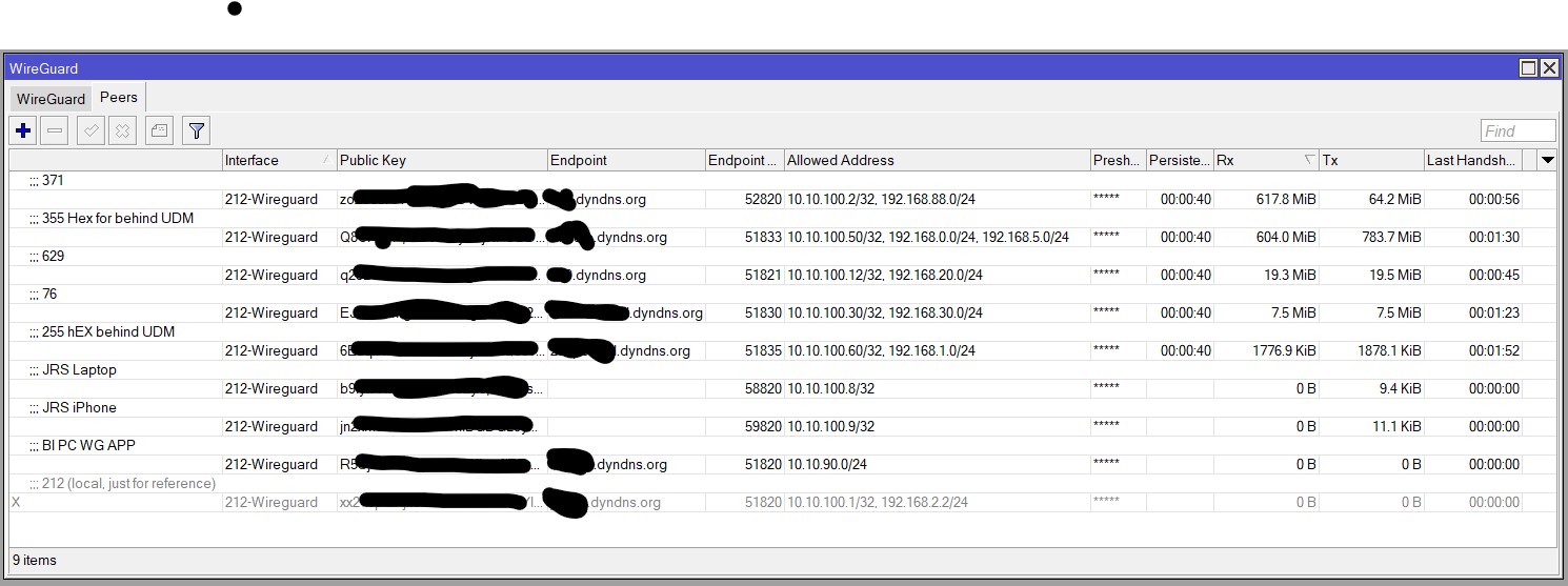

Here are the wireguard peers:

Thanks to you because from the image I think I got mine wrong :laughing:
You have used only one wireguard interface (212-Wireguard) while I created one for each site, everything works but now I don’t know which is the most correct configuration :laughing:
Depends on your use case.
When peers need to communicate with each other, put them on the same interface. Much easier.
I have 3 wg itf.
One private for personal use
One for several devices at work
One for a specific server i daily pull 7gb data from every morning at 5 am (luckily using a backup tool which can work using a schedule :laughing: )
Perfect, now I understand … thanks :grinning_face:
So do I Hoelve is wasteful LOL.
Unless there is overlap between peers, one interface is enough,
I suppose you use bridges for everything and not vlans…
Same concept one bridge many vlans
One wg interface many peers.
KISS,
