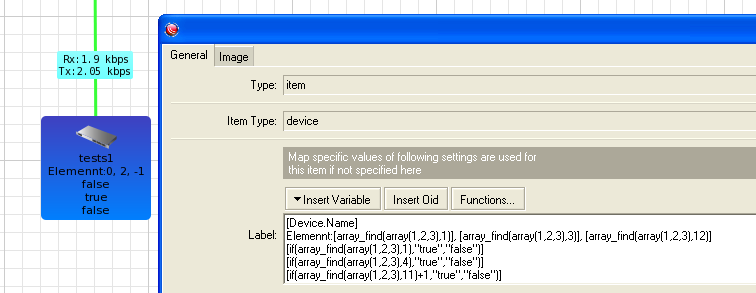

that is not logical
I love that an if statement works inside an array and the first two elements of an array can be added together.
=0 is false
<>0 is true
Right but when you build a probe based on array find, array find returns -1 when it doesn’t find anything, resulting in a true when you expect false…
Here is the syntax for array_find.
returns array index from element that match criteria or -1. First parameter - array, second - item to search for
So you have to be careful when using if and array find together. I think the intention was for -1 to be false??
Also when building a probe using -1 as false will cause the probe to not function correctly.
