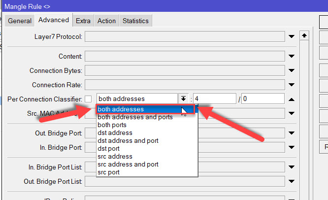

PCC with “both addresses and ports” I used many times works like a charm but breaks https connections.
Then I included !port443 into pcc rules but, since almost all traffic today is https, this mechanism is deprecated.

I would think both addresses and that’s it.

Both addresses.
No ports.

No. That has nothing to do with “breaking https”. It may break certain websites. That is however not related to the use of https, but the destination server or a loadbalancer in front of it keeps your “session” bound to your IP address.

Then pe1chl gave you your answer. Choose only src or dst addres so keep the outgoing IP address seen by the loadbalancer/server on the other side.
There cause is not at your side but on the other side forcing you have the same IP address.

“Both addresses” is normally the best option for optimal distribution (and yes, it may cause havoc on some connections but it’s very rare from what I understood).

Well, i’ll give “both addresses” a try as triple-suggested by Holvoetn :smiley:
