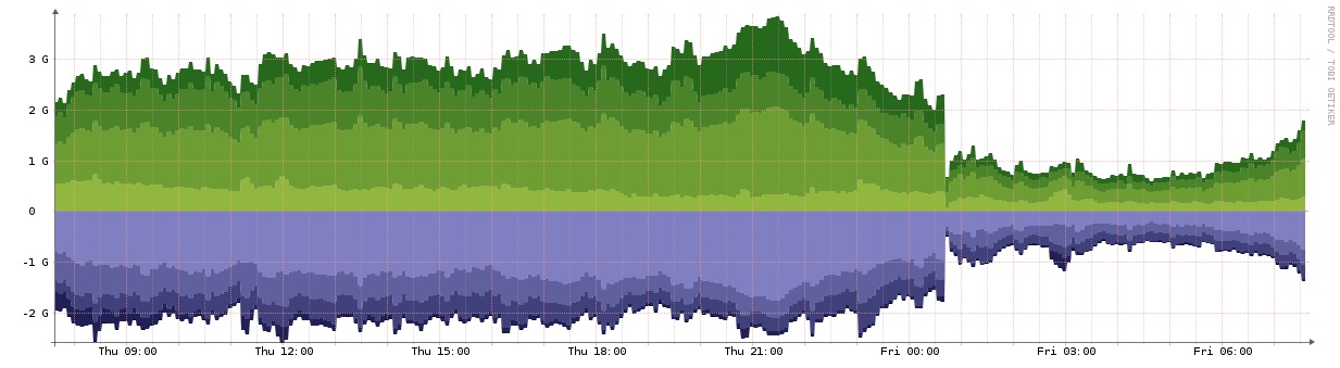

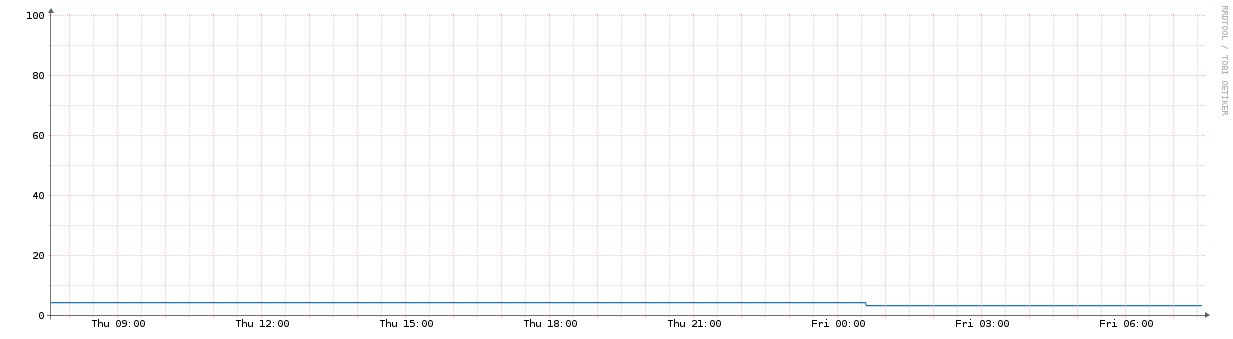

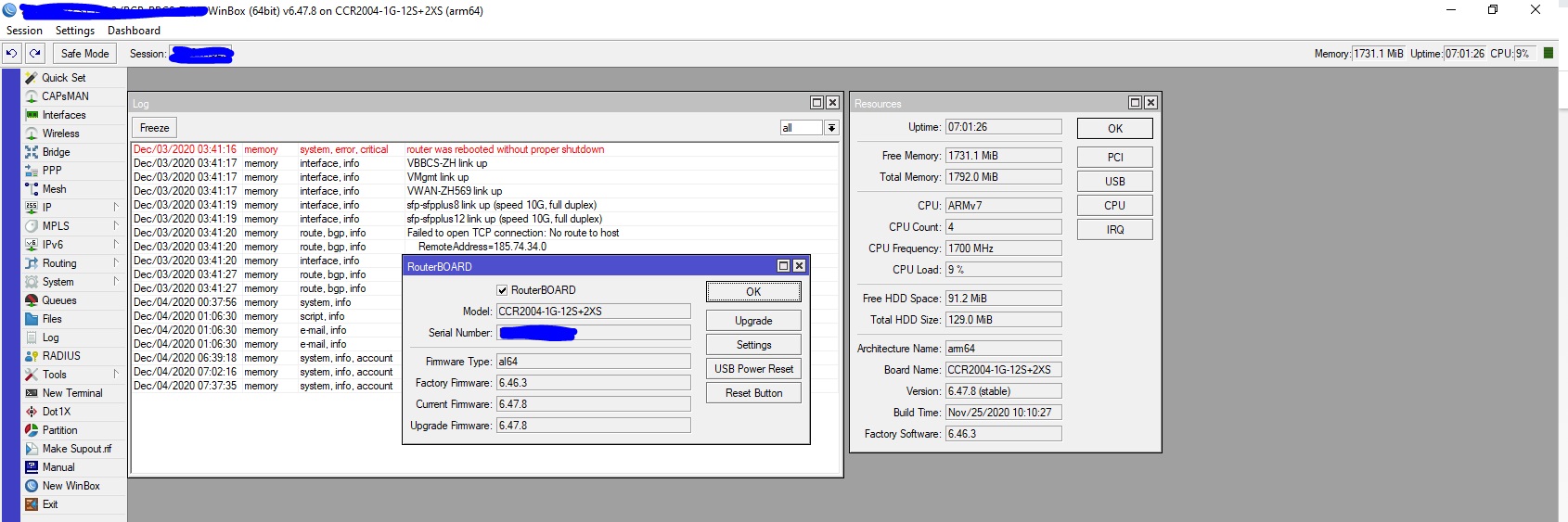

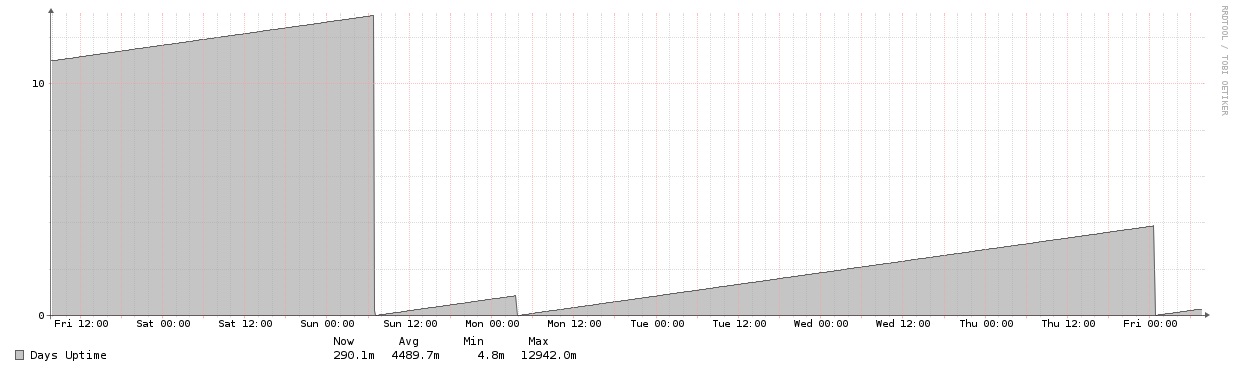

Our CCR2004 has rebooted without proper shutdown during night with 6.47.8. Not fixed yet. It’s not a power problem because this device is in a rack with dual power circuit.
Reboot happens after 3.8 days of running time the 04 December
Thanks for the update, but with the old version it would last up to ~20 some days before it would quit. Sometimes as quick as 8 or so.I do hope they figure it out soon, I have about 10 of these now that will hold paper down, until they are proven again.

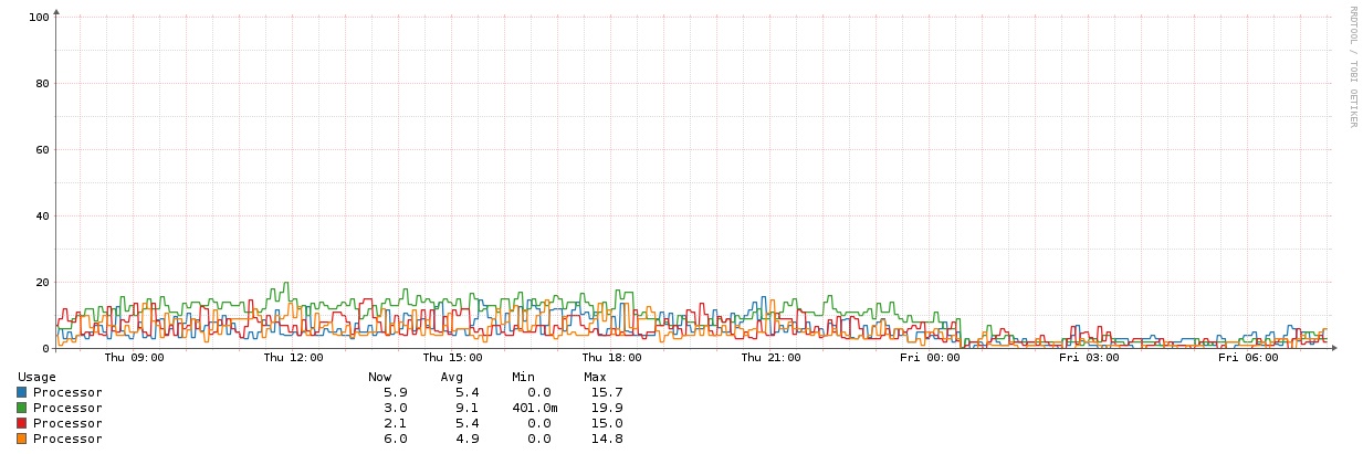

Thats what I was afraid of. Were you able to log into it shortly before it rebooted? Or do you keep cpu statistics? If so were they higher than normal before reboot?
Hi this seems to have been fixed in latest stable - 6.47.8
Yes, of course, nothing really special. It’s not related to trafic, because it happens during night when it’s much lower.
