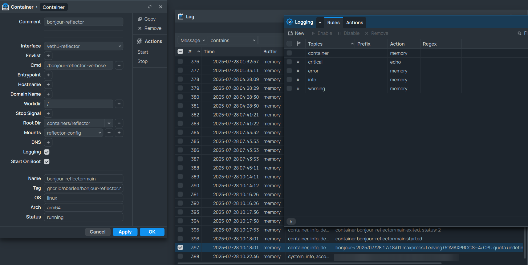

They should be in the mikrotik Log. You should see at least one line during startup about the CPU. Something like Leaving GOMAXPROCS=8: CPU quota undefined even in -verbose is not configured.
If you do not see this line, please ensure that Logging checkbox is ticked in the container configuration. And System → Logging has:
topic=container action=memory
thanks for the reply! everything is set as described, i do see the Leaving GOMAXPROCS=8: CPU quota undefined line in the mikrotik log, but nothing related to the container after that.
