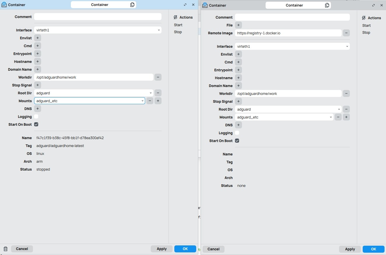

Do you mean like on the screenshot? If so, what about the tag? I set it via the terminal. In principle, I have all the commands saved specifically so that the tags are the same. But I once tried to recreate it and my settings were not saved. But I recreated it in the terminal. Although maybe I did not do it in exactly the right order. And I am also confused by the name of the container. Now it is f47c1f39-b38c-45f8-bb1f-d78ea300af42. The new one, in theory, will have a different name.
Tag is what your file should be when creating.
I’ve done this plenty of times, name of the container doesn’t matter as long as it uses the same folders as the previous container.
As a matter of fact, when you want to upgrade a container, you need to do something similar when doing it manually. Throw away the old one and create a new one with the same settings.
Unfortunately, I didn’t succeed and had to reconfigure. Perhaps I did something wrong. I’ll have to try to create a similar situation myself sometime and try to restore the settings. But I have some doubts about the tags. This time, for some reason, the container was created with a different tag.

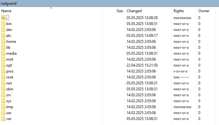

Can you see the files in the mount?
… If so, you should be able to just delete the container - not the mount. And create a new one, using same VETH and mount as before. In fact, if “copy” before deleting, you’ll have all the setting to re-create it (perhaps needing to specify the tag).

Yes, I could go to the catalog. I am attaching a screenshot to finally understand whether I understand you correctly. And I did not delete the mount point. These settings remained and were even picked up in the configuration window. I only deleted the container, but this did not save the settings (block lists, local domain names, etc.)
Not using AdGuard but by simply reading instructions for “Create directories for persistent configuration and data” from its container documentation https://hub.docker.com/r/adguard/adguardhome#quickstart it seems that /opt/adguardhome/conf and /opt/adguardhome/work directories contains configuration files (not sure to what is your adguard_etc mount pointing, but it seems wrong by its name - /etc maybe, there must be 2 mounts for mentioned dirs by their doc) and from this dirs files can be copied locally for backup after each config change, eg. using sftp to ROS, since you mentioned that you are using WinSCP to browse container files, you can backup/restore files from these 2 dirs using it.
