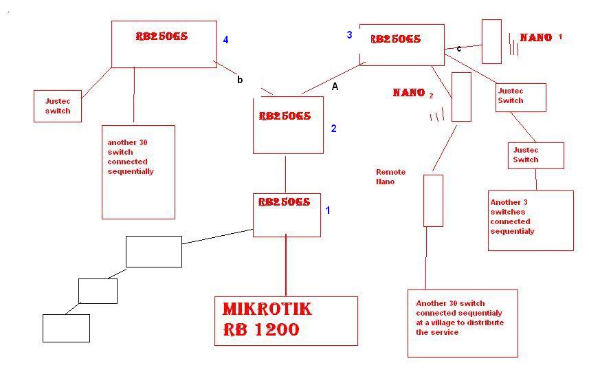

The picture below will explain how my network is ..

When i go at location of RB250 (2) i find the LEDS are blinking like crazy not only in this switch but also at all switches connected to the network .
I tried to disable every possible path to see if the problem resolves ..
Some times when i disable path (b) the loop stops some times when(A).. and sometimes when i disable the cable going to RB250(2) it stops .. (THEN IT COMES BACK ! ! ! )

You have given a diagram but without configuration details from each MT device.
What does “another 30 switch connected sequentially” mean?

From your network diagram it is not possible to determine the source of the loop. Try to limit broadcast storm with broadcast storm control feature:
http://wiki.mikrotik.com/wiki/SwOS#Forwarding_Tab
