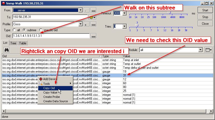

  1. Find the corresponding OID, and copy it on a clipboard

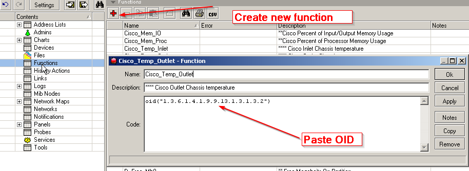

  2. Create function.
  3. Check if function is working correct.

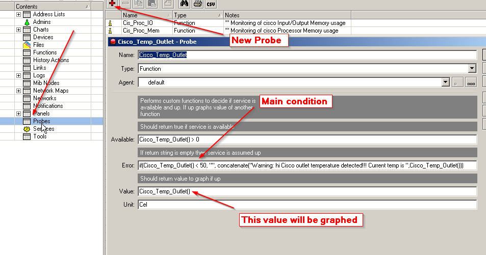

  1. Now create the probe
    The code for probe is
<?xml version="1.0" ?>
<dude version="4.0beta2">
 <Probe>
  <sys-type>13</sys-type>
  <sys-id>10246526</sys-id>
  <sys-name>Cisco_Temp_Outlet</sys-name>
  <typeID>8</typeID>
  <functionAvailable>Cisco_Temp_Outlet() > 0</functionAvailable>
  <functionError>if(Cisco_Temp_Outlet() < 50, "", concatenate("Warning: hi Cisco outlet temperature detected!!! Current temp is ",Cisco_Temp_Outlet()))</functionError>
  <functionValue>Cisco_Temp_Outlet()</functionValue>
  <functionUnit>Cel</functionUnit>
 </Probe>
</dude>

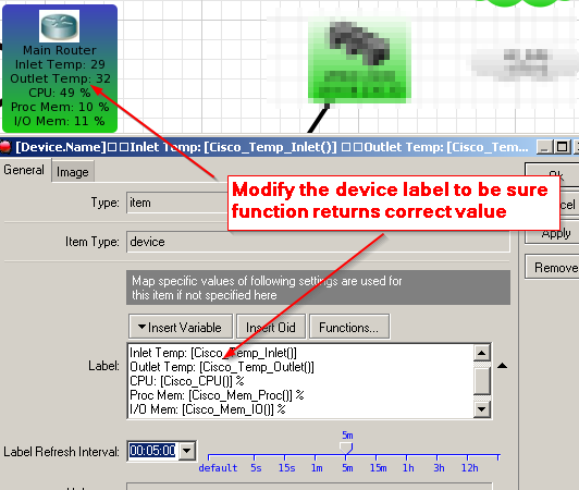

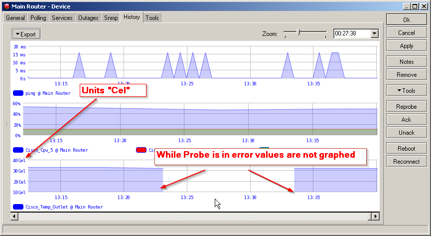

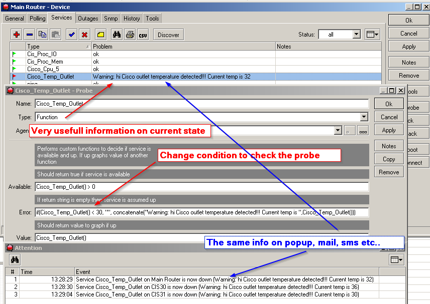

  1. Check if it is working
  2. And now you have the graph of the value you check
    Nice? :slight_smile:
