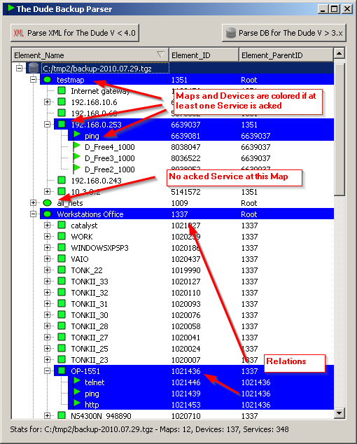

You must know, there is a feature in The Dude - you can make an Service or an Device “acked”. Making service acked is usefull when you know the problem and do not want to have alert on it (for a time). When service is in “acked” state and it is unavailable it becomes blue (not red as when is unacked) by default, when service becomes available it becomes green.
It is good feature, but making services acked is dangerous because you can forget you made it acked and would not receive and alert when service will go from up state to down state, because it will go not in down, but in acked state. May be it is not so, if there is only one The Dude admin, but if you work in a team on admins…
There is no such a feature in The Dude to check the services in acked state. The only way to check it, is to make The Dude config backup and to look in it. But it is not so simple.

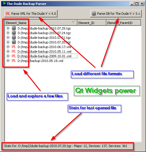

That is why I’v created python script to parse The Dude configs.
Have a look at screenshots
You can download and use it. It is under GPL
