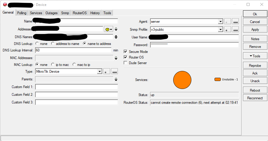

On the remote devices I can see in the logs that it has logged into them, but it does not seem to be registering properly.

NONE of them register properly in DUDE since the upgrade.

I found the solution… There were some NAT and Mangle rules I had created years ago to enable The Dude to talk to some remote mikrotik devices on ports other than 8291. These had malfunctioned/broken in the upgrade to 7.2. I’ll have to go back and figure out why, but once I disabled these everything started working.
