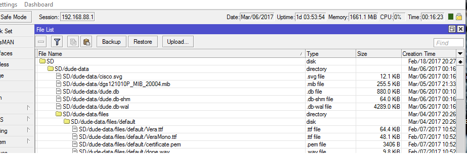

Dude 6.38.3 I upload svg file and MIB on dude server on right file path, but I don’t see them in MIB list and images.I try to reboot but probem continue.
Dude is instaled SD/dude-data. And here are file upload.

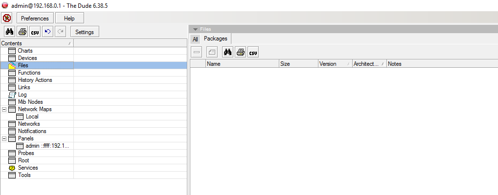

I dont have + in files to add routeros-mipsbe-6.38.5.npk
any help?
Did you try the upload button?
Thing changed when updates went to the RAM instead of the flash so no more “+” button. The Wiki should be updated on this when there is time.

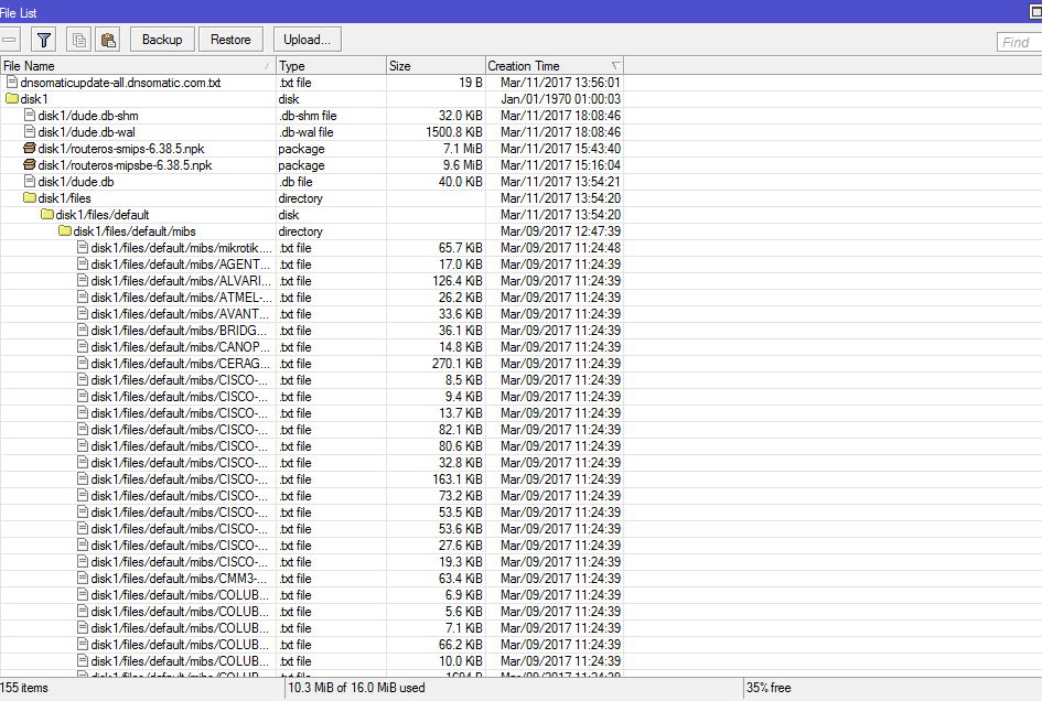

i try upload file with winbox..
in flash and in SD card
cant see in dude
so i cant auto mass upgrade

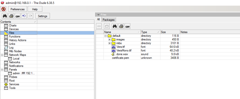

I update Dude to 6.38.5 problem stay… Any file uploaded to server can’t be used. Try with UPLOAD button and also to drop file…same.

I enter the dude server installed device and add the packages to the under dude/files/
Hi Nemke
you need to add the file which you need into the “(data-path)/files/” directory." via Winbox
You can check the full wiki in this page : https://wiki.mikrotik.com/wiki/Manual:The_Dude_v6/Files
But I think the upload function is not friendly.
You only can upload the file to the main folder , then push it in to “(data-path)/files/”

Solved: I managed to work around the problem by creating a folder structure on my local PC e.g. /dude/files/[filename}
Then drag the entire file structure to Winbox. This added the package in the correct place and it appears in Dude monitor under Packages.
