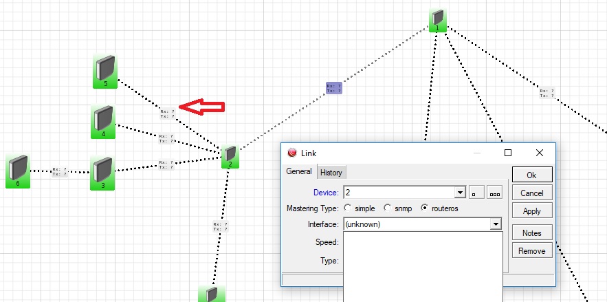

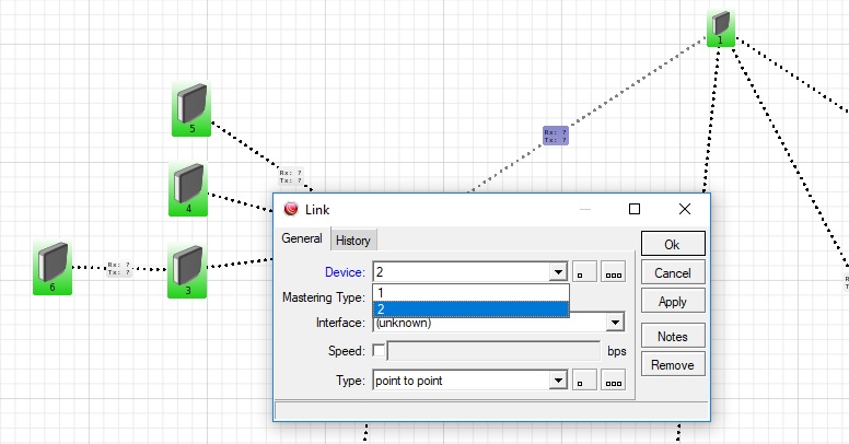

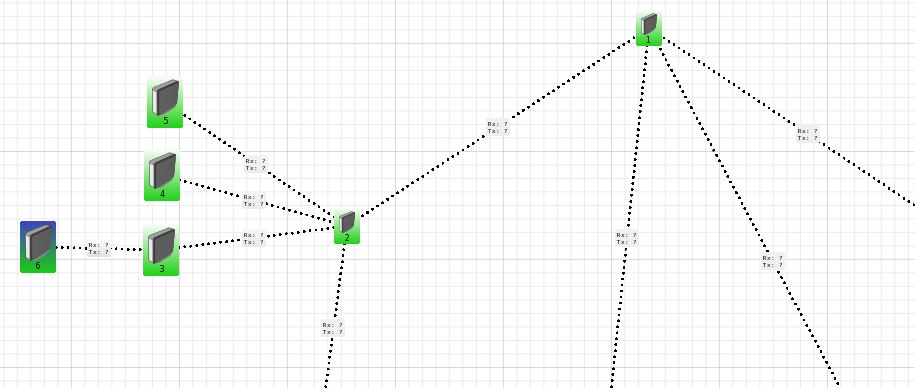

when I add a link between devices I have already added, and I put the mastering Type on “routeros” then thee Interface drop list is completely empty … and after making the link done , there is no rx/tx rate on the link …
could anybody tell me what is the problem ?
I have attached some photo with the purpose of making the question more clear.

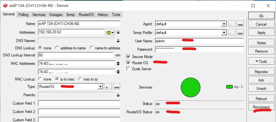

Have you set the type to RouterOS for each device?
Check your settings for RouterOS. Do a reconnect if RouterOS status is not OK

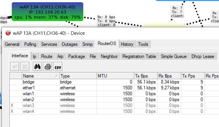

What do you see in the RouterOS tab ? Interfaces should be there.

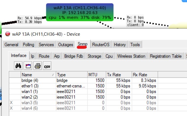

You can do exactly the same with SNMP on MT.
