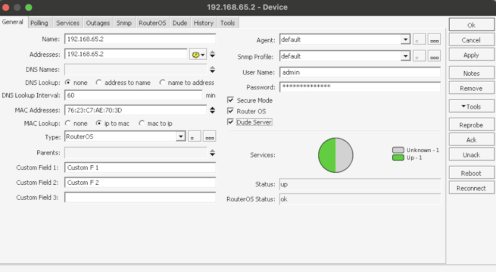

Dude Server is connecting to the devices from the RouterOS and it should follow routing table entries.
If we are speaking about a single device with multiple interfaces which is Dude Server as well, ROS should connect to the IP we set in the General tab.
When Device is RouterOS, we should make sure that IP/User/Password are correct and Dude IP can connect to that device via WinBox service.
  1. Check you device IP in Dude
  2. Check device credentials in Dude
  3. Check if WinBox service if not limited by IP/Subnets in RouterOS

There are just two differences between your screenshots and my tabs.
First is in the device tab of Dude client, where in mine there’s two MAC address: one is from ethernet interface and the other is from bridge (but also the same MAC address of another ethernet port).
The second is in Services tab of Winbox, where in mine the port of Winbox is not the standard port.
Do you think that the issue maybe is in this port difference?
The “RouterOS Status:” in Device tab, is always in “connecting”.
About the device IP address, it’s correct.
The credentials for Dude connection are OK and Winbox service have no limitations.
Many thanks again.
Thank you for sharing that :slight_smile:
We have a Dude v6/v7 - Known bugs topic and one related post there - Dude - Device RouterOS on no-standard Port.
Is there a way to check how it works with a standard WinBox port 8291?
