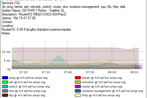

Very interesting indeed… OK, voltage/temp/cpu/memory, is that drawn from other Mikrotik devices (besides the one on which the Dude is operating) eg. switches…?
Also from other mikrotik devices - see sample attached

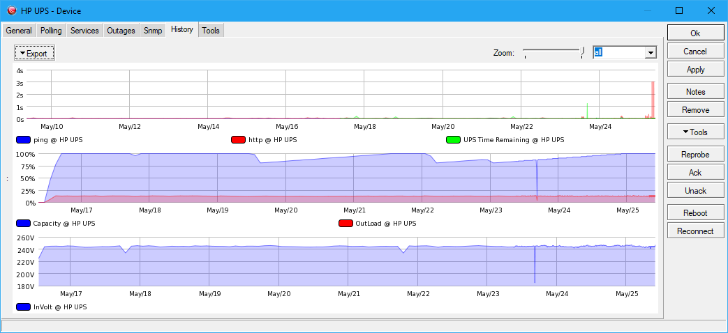

Same goes to UPS (I had to create own functions and probes to handle things like Remaining Capacity, Input Voltage or Output Load) and other critical devices.

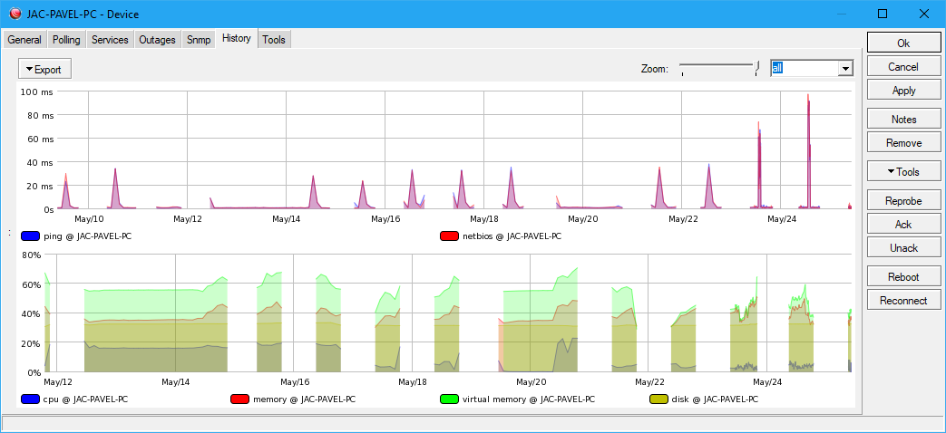

Dude can directly connect to any RouterOS device as long as you provide login details. It can also connect to any SNMP enabled device. For example here:
As you can see, you can monitor not just responses (service up/down) but also value of almost any available parameter. Some probes are predefined but you can easily create your own with a bit of scripting.
On next image you can actually see how is computer being used - when employee turn it on/off, how much cpu/memory is being utilized.

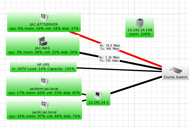

On map, you can also see summary of current values (you can actually design these labels by yourself so it can show any textual info). It is really easy to pick up if any computer is running out of memory/storage and each link can show its utilization based on its current speed and capacity.
