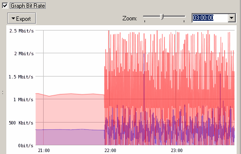

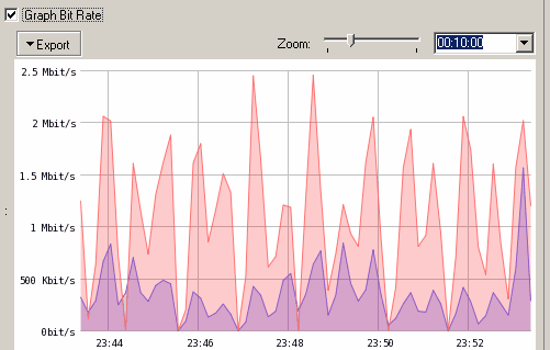

1. The Chart and History graphs are showing some strange behaviour. It shows quite different values depending on the zooming of the chart, i.e. if I zoom in so that only the last ten minutes of activity is shown it looks like this:
If I however zoom out to show the last three hours of activity, it looks like this:
This “feature” is also seen on charts.
It seems as if the last two hours of activity are stored “as-is” while anything after that is stored as some sort of “mean-value”. Perhaps this is by design and I just have missed something that is obvious for everyone but me? :open_mouth: :smiley:

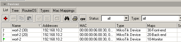

2. Everytime I want to include a device on more than one network map then the device needs to be re-declared for each map. Would it be possible to let The Dude include the same device on more than one map at the time? As you can see the same Mikrotik device is available on more than one map, i.e. on the map for VLAN 30, on the map for VLAN 20 and on the map for VLAN 10:
The result is that this device has to be declared three times, which I find to be a bit unnecessary since all info regarding monitoring, etc. is already defined in the first device declaration.

check your chart keep times:
http://wiki.mikrotik.com/wiki/Manual:The_Dude/Server_settings#Chart
also configurable per chart
