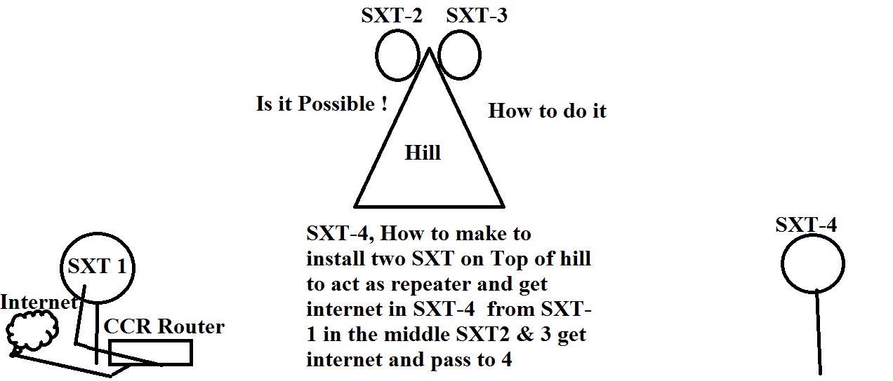

Experts, I am quite confuse and new on this field.
I need advise step by step if it is possible, as per below Diagram I need to reach Internet in SXT-4, the problem is in middle I have small Hill, and thinking of to make it possible.
I have tried this way…
SXT-1 Bridge SXT-2 station Bridge and then connected to a normal 8 Port Switch then I configured SXT-3 as Bridge and connected on same 8 Port Switch and SXT-4 as Station Bridge
IPs assigned on this way all SXT function as bridge mode.
SXT-1 IP 192.168.50.5 ( interface Bridge), SXT-2 192.168.50.7 ( Interface Bridge) connected in switch SXT-3 IP 192.168.50.9 ( Interface bridge ) connected in Switch and finally SXT-4 IP 192.168.50.11 ( Interface Bridge ) connected in my PC, I can ping to .5, .7 and .9, but when connect the SXT-1 to Internet and trying to get Internet in SXT-4 it is not working.
I think I am doing wrong.
Seems that default route is missing. Can you see ccr from sxt4? Maybe just dns server is not known…
I checked that Sir, when I connect my PC from SXT-2 I can get internet, but when I connect from SXT-4 cannot.
However I can ping all IPs from SXT-4, even I did bandwidth test locally from SXT-4 to SXT-1, but this is strange how not working the Internet.
